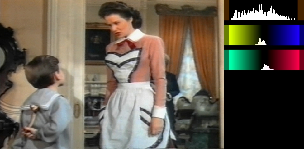

  4. There's one other thing you might try: copying the VHS chroma channels onto the laserdisc luma. The colors won't be as sharp. You'll have to adjust the frame sizes/cropping to get the channels to line up. And you'll have to make sure the frames match. Here's an example using the two images in post #21, luma from the laserdisc (levels modified) and chroma from the VHS:
    I didn't resize and position the chroma exactly, but you get the idea.
    v1=ImageSource("Laser.png").ConvertToYUY2()
    v2=ImageSource("VHS.png").BilinearResize(720,540). ConvertToYUY2()
    v1=ColorYUV(v1, gain_y=-70, off_y=15) #adjust levels a bit
    v2=ChromaShift(v2,c=-10, l=4) #shift the chroma left and down
    MergeChroma(v1,v2)

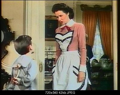

  5. Work with the vhs cut, i propose this:
    Or this perhaps:

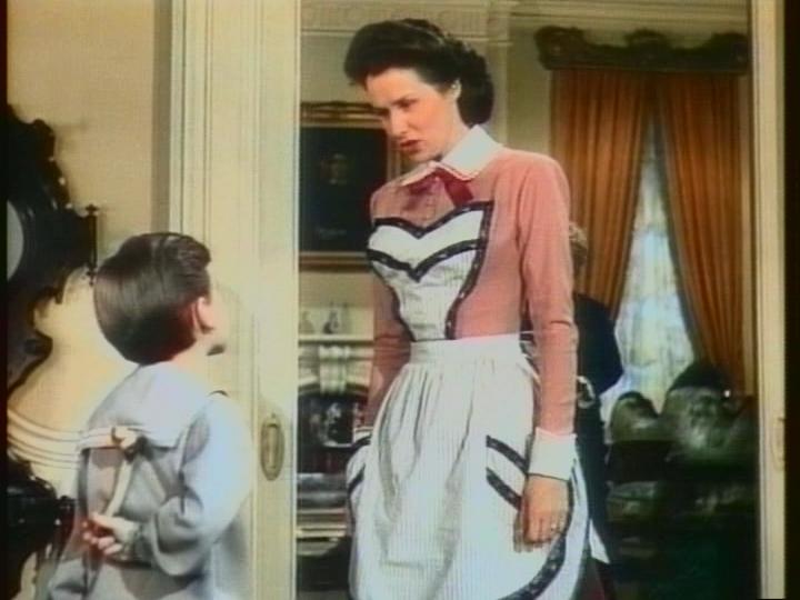

    I was able to recover some bright details. And I adjusted the colors a little different than last time:
    [Attachment 9130 - Click to enlarge]
    Nice work there jagabo
    When you were looking at the full YUV range, did you see any evidence of the image clipping at some level above Y=235, or did it go all the way to 255?
    The reason I ask is video on laserdiscs is analogue, right? Is it possible that the video on the disc is out of spec and overloading the LD player. Or maybe the player itself is outputting a signal outside the legal range which is overloading his capture device.
    Little can be done if it's the former (short of trying a different LD player), but if it's the latter, Mike could try a basic video processing box inline between the LD player and whatever he's using to digitise the video to bring down the levels.

  19. Originally Posted by intracube View Post
    The luma values went all the way up to 255. It was obvious the peaks would have been over 255 but they were clamped, of course.
    Yes, it's possible the problem is on the laserdisc. The DVD recorder (or capture card) would look at the depth of the horizontal sync pulse to adjust the automatic gain. If the pulse wasn't low enough there would be too much gain applied to the picture.
    Yes, an analog proc amp might help.

    Mike99's laserdisc sample shows contrast problems with both the black and white levels. DVD recorders often have compensation for the difference between NTSC-J and NTSC-US. It's usually called "dark" and "light" or something like that.
