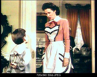

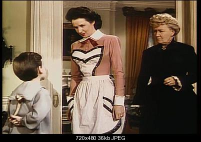

    I was looking at histograms of frame captures which are RGB.
    The first one is from the LD sourced DVD.
    The second one is from the VHS sourced DVD.
    I'll have to make some shorter video clips in order to post them.

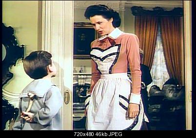

  22. One of the biggest problems you have is the laserdisc cap has blown out brights. You might be able to restore a little of those brights by adjusting the levels of the MPEG2 data before conversion to RGB.
    I played around with just the chroma channels a bit and got the colors a little closer:
    ColorYUV(off_u=8, off_v=-8)
    ColorYUV(cont_u=100,cont_v=250)
    Some fine tuning should get the colors a little closer. But I'd work at recovering some of the bright details first.

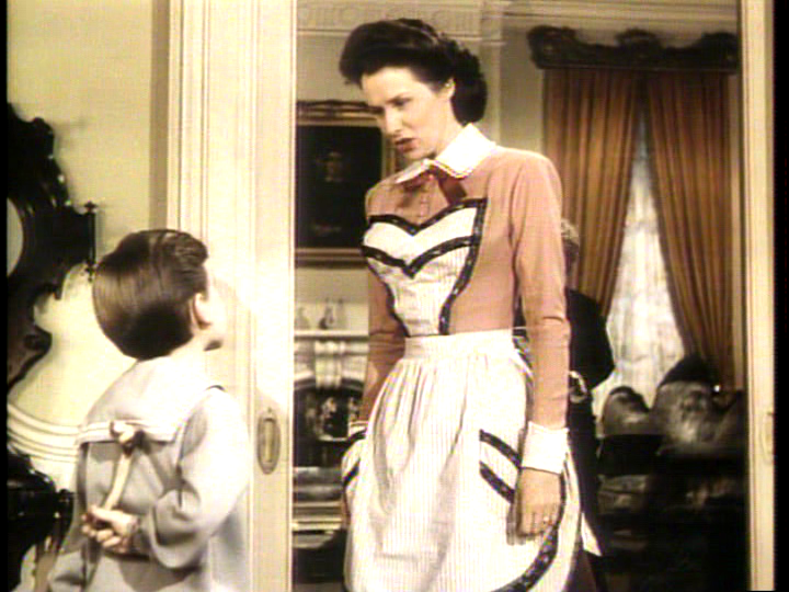

  26. I was able to recover some bright details. And I adjusted the colors a little different than last time:
    Mpeg2Source("DGIndex Laser.demuxed.d2v", CPU=2)
    TFM(d2v="DGIndex Laser.demuxed.d2v")
    TDecimate()
    ColorYUV(gain_y=-25, off_y=2) #adjust levels
    ColorYUV(cont_u=175,cont_v=225) #increase saturation
    ColorYUV(off_u=20, off_v=-20) #white balance, apron as reference
    McTemporalDenoise(settings="high") #noise reduction

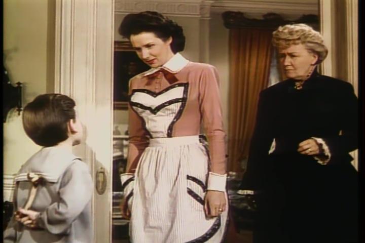

    If the midrange is brought down into line, it won't be necessary to oversaturate or brighten. Looks to me like the LD has a midrange/levels problem and trouble with blue and green. IMHO the apron isn't pure white, the collar is. This is just another way of doing it (Levels set in YUV, the rest with VirtualDub's with grad curves and levels in RGB). You have to spend some time fiddling with the levels, color isn't so difficult once the midrange is set:
    [Attachment 9132 - Click to enlarge]

  29. Yes, that looks a lot more like the VHS version. For levels I was shooting for the brights at IRE 100 and the darks at IRE 0. For the OP, a similar correction with AviSynth would roughly be:
    ColorYUV(gain_y=-80, off_y=50, gamma_y=-100)
  30. Banned
    New York, US
    Nice, jagabo. One of those things you could fiddle with forever. That LD color and levels are pretty awful. 40's and 50's color was often overly warmish, and old film poorly stored would lose its brilliance. Many digital transfers were, uh, "digitally mastered" with no thought to good PQ. If the source was yellowed, grainy, or just godawful, that's the way it went to market. Pain in the neck to fix, and you never really know how the original looked.
