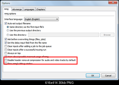

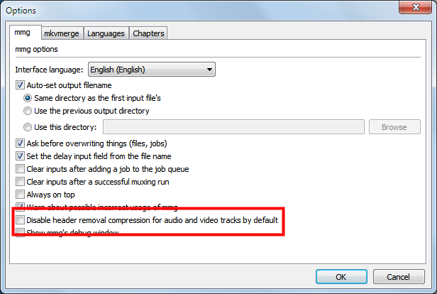

  18. Originally Posted by aedipuss View Post
    get the latest version of mkvtools and make sure to turn off header stripping in the settings
    File -> Options:
    Turn that feature on for maximum compatibility.

    Talking about MKVmerge, sometimes the "disable header compression" trick is not enough.
    What should be done is what I explain here in way 2:
    https://forum.videohelp.com/threads/337066-Understanding-MKV-files?p=2110022&viewfull=1#post2110022
    That should guarantee compatibility.
