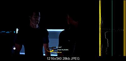

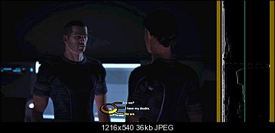

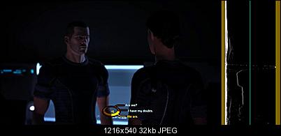

  11. The source video has too low a black level (from mp4 files at youtube):

    The vegas file looks like it's been through some auto gain filter:

    Probably what it should have looked like:

  12. No it's a youtube mjpeg issue . It decodes mjpeg at full range (libavcodec issue)

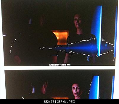

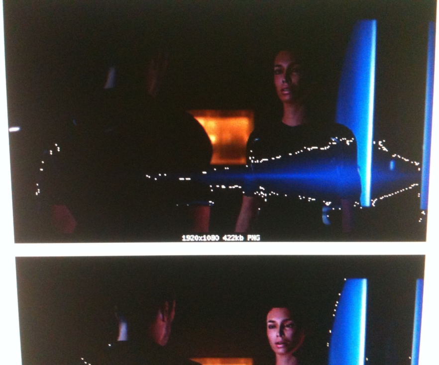

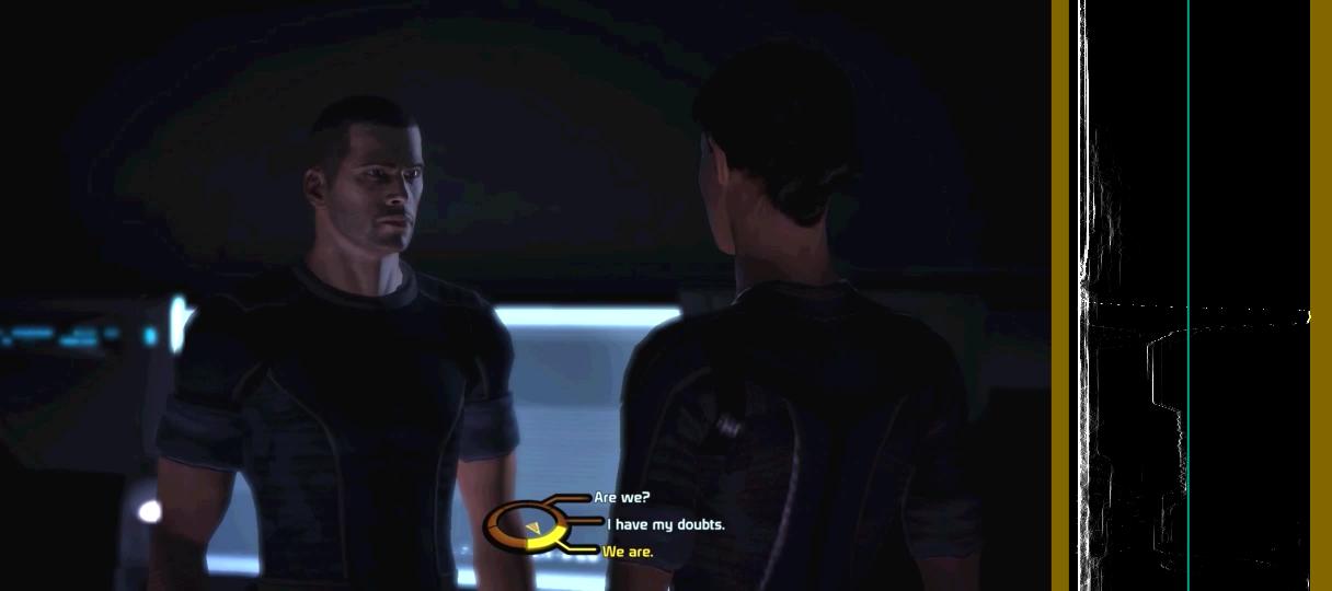

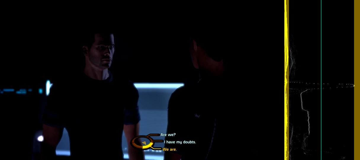

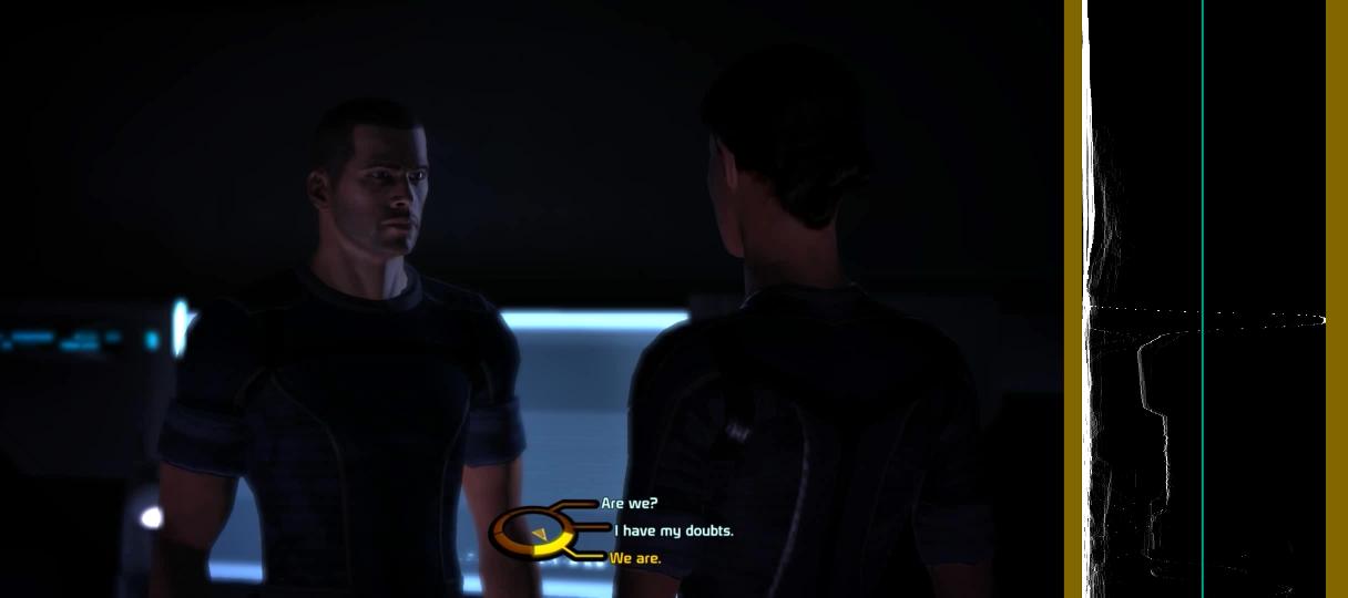

  22. Check this
    1 - Default
    2 - Forced YUV output in PicVideo decoder
    Both ecnoded in vegas.
