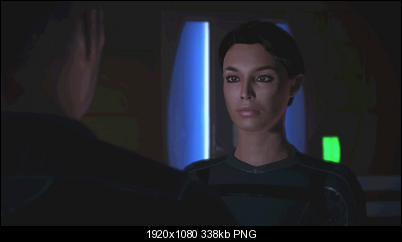

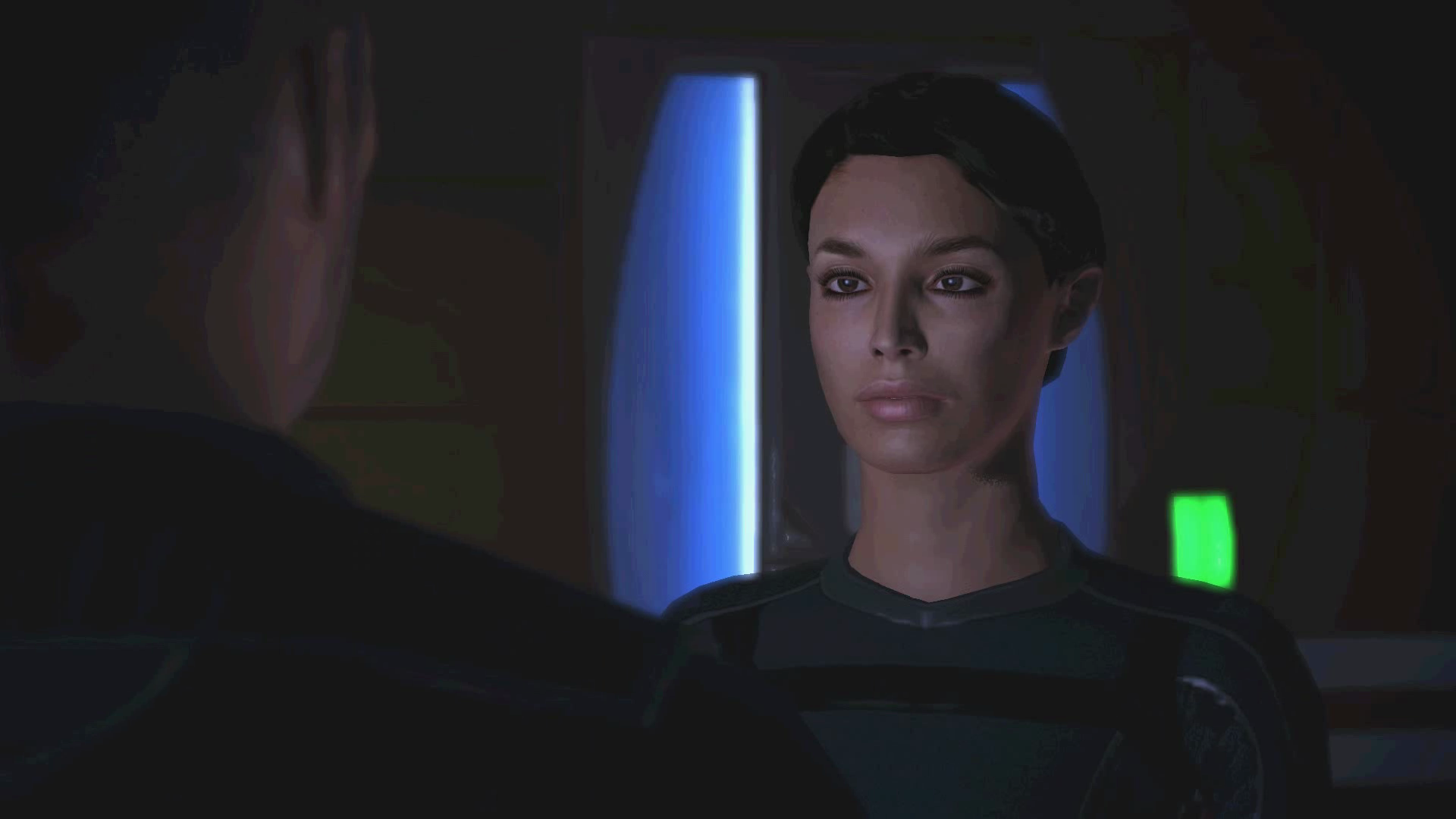

  1. Greetings folks, i hope you can help me with this issue.
    I am using PicVideo MJPG codec for recording, and when i encode in vegas, i am getting some strange artifacts.
    I assume problem in color space? Any suggestion?
ID:	8993 - Sony Vegas
ID:	8994 - VirtualDub

  3. The Vegas image is showing posterization artifacts -- usually caused by a reduction in bit depth (24 bit RGB to 15 or 16 bit RGB, for example).

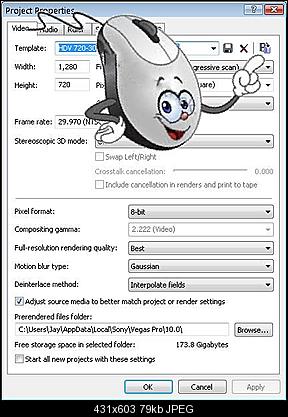

    Try matching the project to the media.
    Any way to fix that?
    [Attachment 8997 - Click to enlarge]
    Same issue.

  14. I think jagabo is right - it looks like a reduced color palette
    Check your export settings. I don't have vegas open right now bit it will say something like 24bpp (bits per pixel), that's 8 bit for red, green and blue each . Anything lower than that will cause what you are seeing . "32bpp" is ok, but that just renders a dummy alpha channel (RGBA , 8+8+8+8 =32)
    It was Xvid 8k bitrate, i don't think problem in codec, i am seeing it even in preview.
    Do you mean you see this in vegas' preview window, before encoding ?
  15. Originally Posted by aedipuss View Post

    A gamma tweak WILL solve the issue. It's a black level problem.
    Cant find it.
    The source is 4.2.2, so you need to change the project settings in Vegas to Sony AVC.

    Then that suggests an import or decoding problem, not an encoding problem by vegas or xvid vfw
    If you are using 8bit project settings , try 32bit either full range or video levels
    This smells like a studio RGB problem with vegas

  20. OK I didn't see your youtube post
    I think there's 2 different problems here. One is import and one is export
    How did you take the screenshots in the 1st post? Did you notice the gamma curve and overall brightness is roughly the same between the two? It's only the posterization difference
    But the youtube comparison shows different levels, different curve
    This is likely a studio RGB vs. computer RGB issue with vegas
    http://www.glennchan.info/articles/vegas/colorspaces/colorspaces.html
    http://www.glennchan.info/articles/vegas/v8color/v8color.htm
    http://www.glennchan.info/articles/vegas/v8color/vegas-9-levels.htm
    Long story short, different formats are treated differently in vegas, some get studio RGB treatment (16-235), some get computer RGB treatment (0-255). Furthermore, the export format chosen can change the levels, because vegas "expects" certain levels for different formats. Sometimes you have to apply studio to rgb filter or vice versa and play with the various 8-bit vs 32-bit fullrange vs. video levels settings
    What you see on the monitor is not necessarily reflective of what you're going to end up with, unless you have external monitor setup and configured

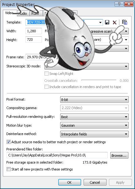

  21. Member budwzr's Avatar
    Apr 2007
    City Of Angels
    Here's the color corrector:
    [Attachment 8999 - Click to enlarge]
    Set the preview window to BEST/FULL when doing this.

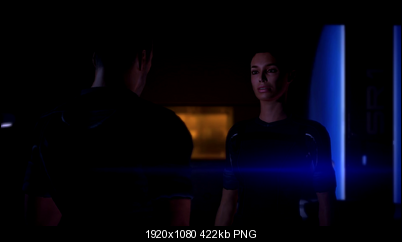

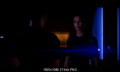

    vlc plays the source.avi fine here budz. but, interlaced mjpeg? i didn't know you could even interlace mjpeg. what a mess that must be to de-interlace.
    vegas doesn't seem to have any problem going to sony avc.
