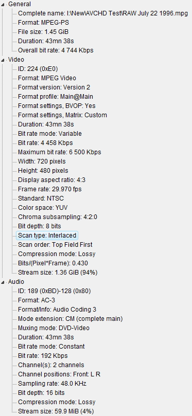

  9. Here's my MediaInfo screenshot:
    The website of the author of the program was taken down long ago and development on the program was also stopped long ago. Does the author still post on any forums? If so, please let me know and I'll ask him about my problem.
    Has anbody successfully made DVDs (without re-encoding) using MultiAVCHD? If so could you please let me know what settings you used. Thanks
    [Attachment 8991 - Click to enlarge]
