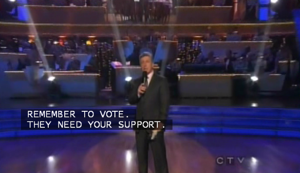

  3. Thanks for the reply. Here is an update. I figured it out. I wanted to see if I still got the CCs with analog cable, as I did two years ago, so I disconnected the digital cable and hooked up analog again. I made a DVD recording to a folder, used IFO Edit to set the CC flags, burned the recording to DVD, played it, and, surprisingly, the CCs were still absent even in the analog, which wasn't the case two years ago.
    I started to think that this was perhaps a driver issue. I had the latest HVR-1950 driver from January of this year, but remembered that when I used to get CCs from analog two years ago the driver was from August, 2009. So, I hunted down the driver from August, 2009, ran hcwclear to remove the new driver and WinTV software, reboot the PC, then installed the August, 2009 driver and reinstalled WinTV. I then hooked up the cable to digital again, made a recording, authored it to a folder, ran IFO Edit to set the CC flags, burned the recording to DVD, played it and the DVD had the closed captions. It's pretty stupid how the new driver removed CC support. If anyone needs the old driver, I can provide it.
