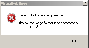

  17. I did test using a dozen or so AVI codecs... I did test uncompressed as well... NONE imported successfully imported the file into MPEG Streamclip. AND this is for prepping files for editing in NLE's like Premiere or Final Cut Pro. I can use the AVI's fine on the PC side for Premiere Pro... but I sometimes need to edit on a Mac using Final Cut so ... I have to convert to MOV.
    I tried the Cedocida codec... it gave me an error when trying to export a simple DVD rip to VirtualDub...
