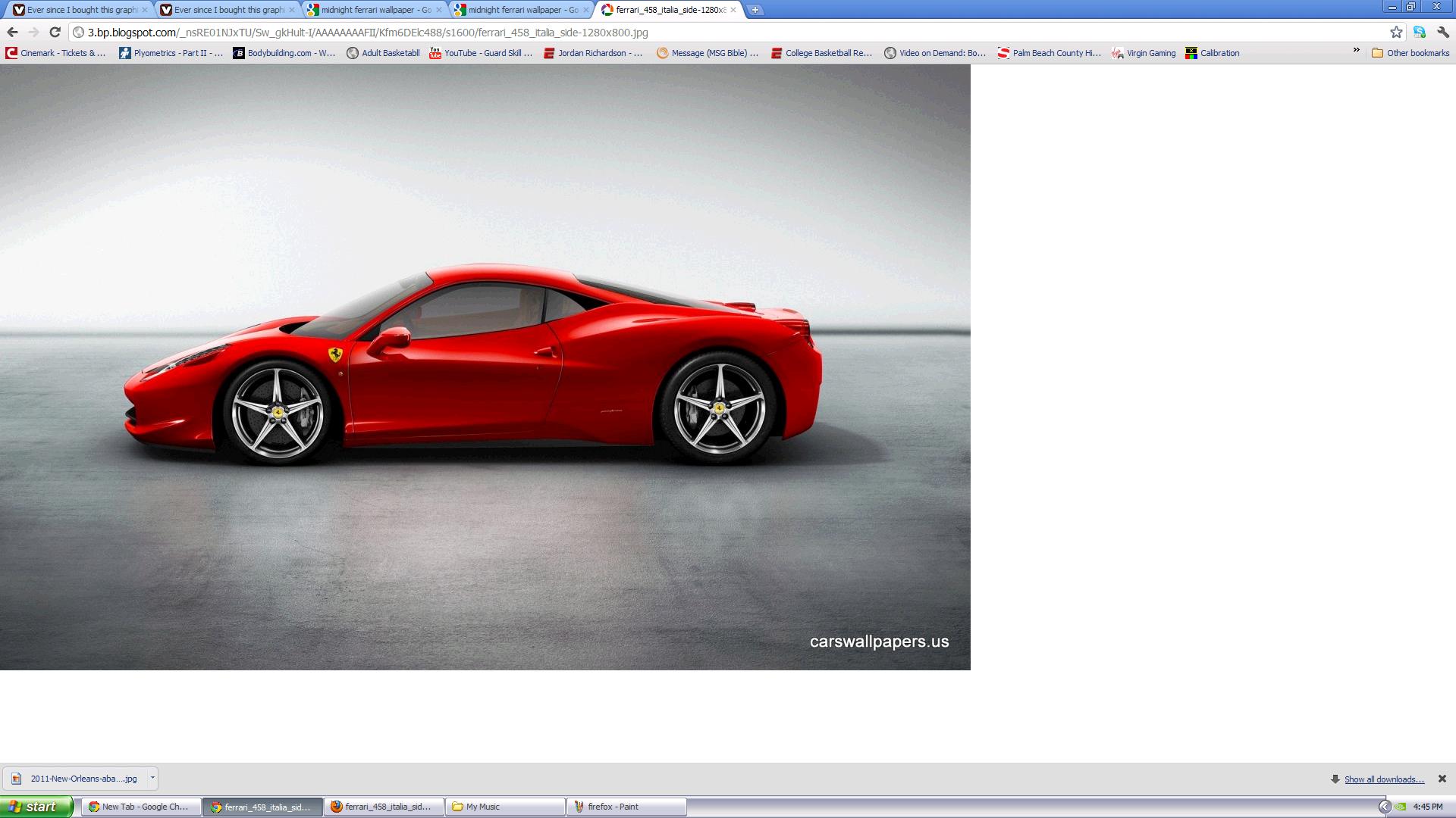

    But ever since i did the picture quality on my videos and pictures in dark scenes on the background just look wrong. If u take a look at these screens i posted u can see.. is this bcuz the graphics card is bad or does graphics card even have to do with picture quality? IF anyone knows why my videos look like this i appreciate it bcuz before i bought this graphics card it didnt look like this..

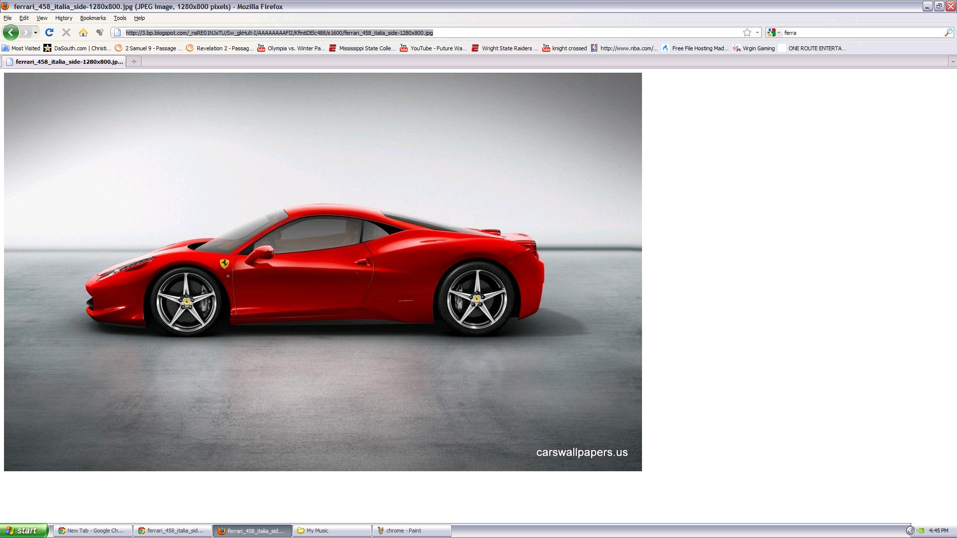

  9. Ok thats from a blu ray so its not the cartoon that has bad quality i have seen what it looks like when i dont have this issue. So what fixed this for me, and i dont really know why, but i went into my graphics card control panel and what was causing the bad picture was when the display settings were on "clone" which just makes whatever is on my monitor appear on my tv. The picture is normal when i have the settings on single or if i put it on "dual-view" which allows me to drag things from my monitor to my tv, as if you were using dual monitors. This isnt a problem for videos i will just leave it on "dual-view". But so by a fluke, it seems like the pictures on google chrome is what is wrong because when i view it on firefox there is no problem. This is what my pictures look like on chrome and firefox:
    and this is the link to the wallppaer if u wana view it urself: http://3.bp.blogspot.com/_nsRE01NJxTU/Sw_gkHult-I/AAAAAAAAFII/Kfm6DElc488/s1600/ferrar...e-1280x800.jpg
    now why is it that on chrome the picture is bad any1 know? i cant find any settings that would change it?

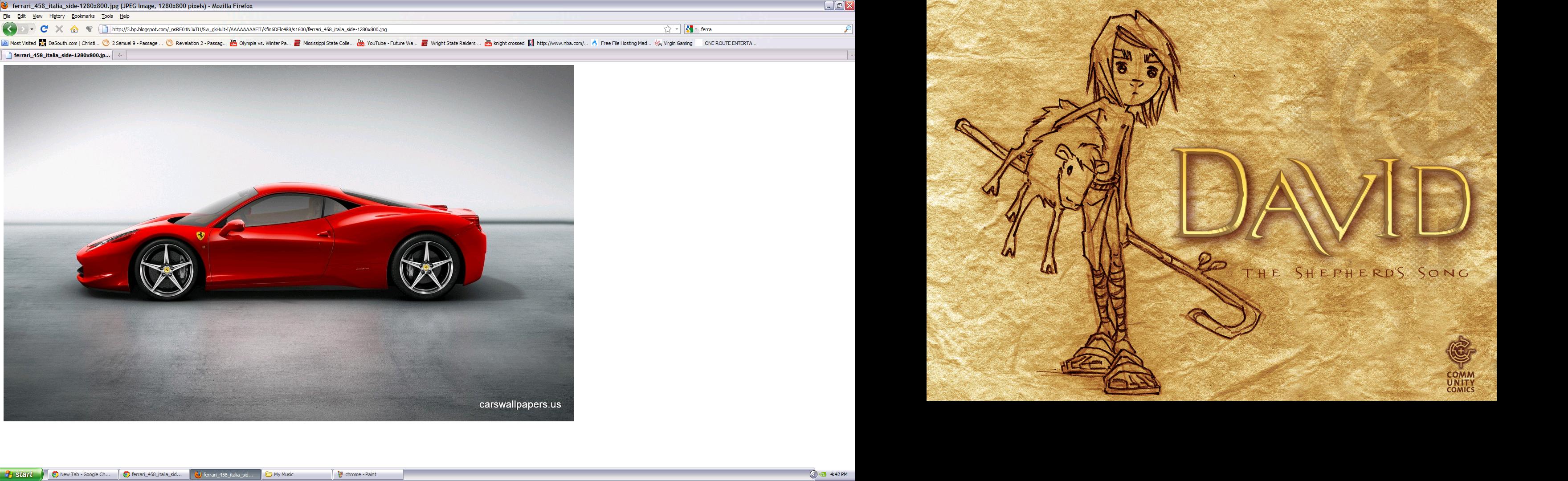

  10. scratch the last post... these attachments are easier to see. look at the background difference.
    It might not look like a huge difference, i couldnt really find a better picture its easier to see on dark pictures but u can tell what im trying to express.

  11. Chrome appears to be displaying your picture with 16 bit color, not 24 bit color.
  12. Yes! You're right the reason is because my settings were at 16-bit. I put it as 32-bit and now the pictures are fine. But for some reason it wont allow both my monitors (dual monitors) to be at 32-bit.
