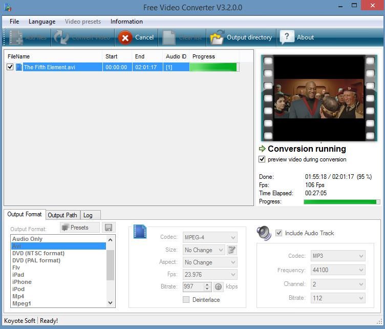

  6. For those wanting to do exactly this then download Koyotes Free Video Converter
    https://forum.videohelp.com/images/imgfiles/IlTg0LWh.jpg
    Set your pre set and save it for later use as the program won't remember them
    It's a oldie but a goodie (clean too) and a tiny program compared to the crap you have you to pay for! Enjoy.
