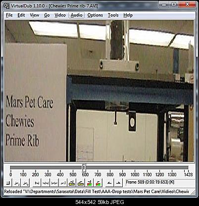

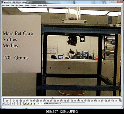

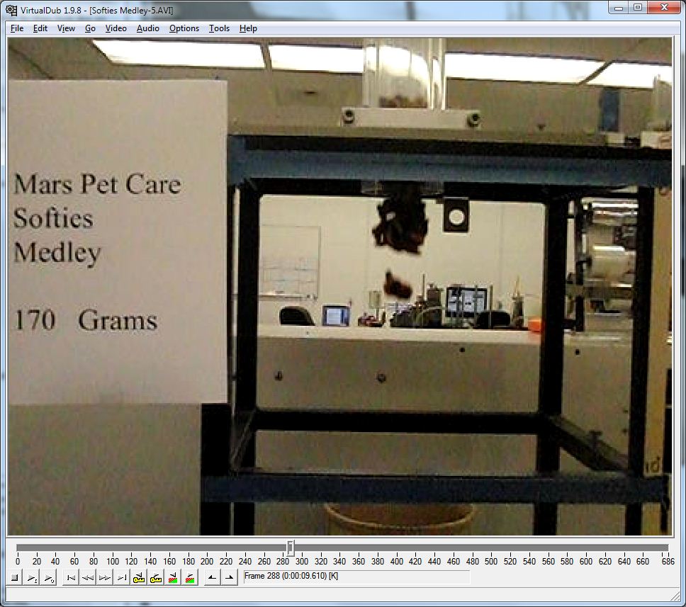

  1. I use VirtualDub for analysis of high speed videos. I have been training another user to do the same work. My computer runs the 64 bit version and his runs 32 bit. For some reason the 32 bit version does not properly display the input frames. I have been running both side by side on my machine and I have the same error. See the screens below:
    64 bit
    32 bit
    Video inputs are the same. All settings are the same. The only difference that I have been able to find is the MJPEG codec appears to be different between the two versions of VD. I cannot for the life of me figure out what is going on.
    Does anyone have a guess as to what is going on here? I have struggled with this all morning. Any input would be appreciated.

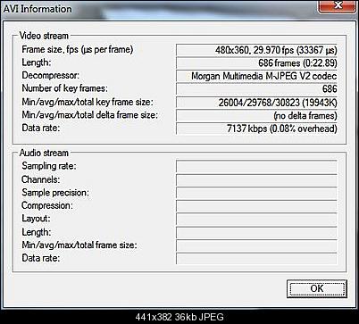

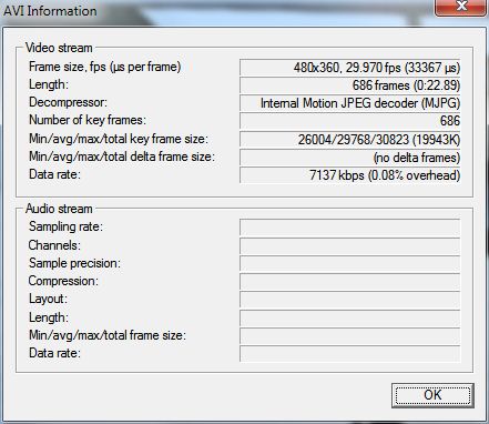

    I have installed both versions of ffdshow, but I don't know how to change the codec that VirtualDub uses. The plugins for VirtualDub were installed. How can I force the software to use them?
    Current info for each file is shown below.

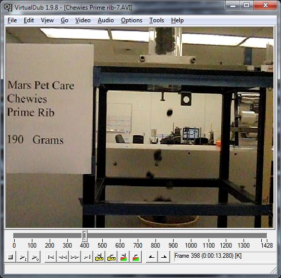

  6. Your screenshots are of different frame numbers between the versions. What do they look like on the same frame ? Vdub reports the same frame count
    The other difference looks like aspect ratio. Right click the input & output pane for the display and make sure they are setup the same way

    Yes, framecount is the same, but your individual screenshot is on a different frame . Try comparing the same frame. Look at the bottom right hand corner, it tells you the frame number . Or look where the slider is 398 vs. 598
    Also I edited my reply above, check it and make sure the aspect ratio display is setup the same way

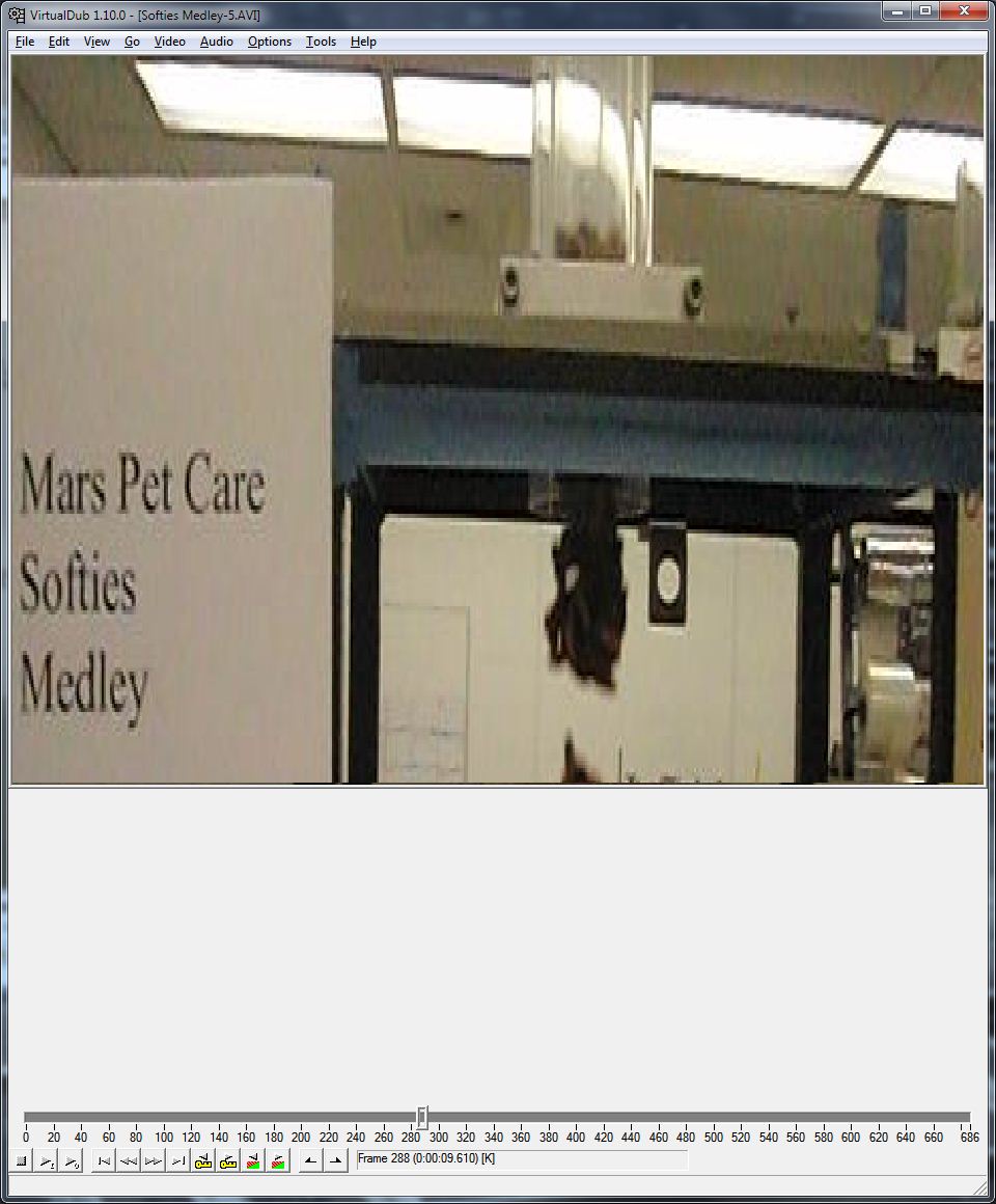

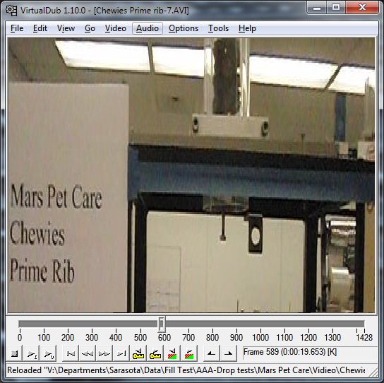

  10. Okay screenshots below are of the same frame. Looks right.
    I double checked aspect ratios. They were on free adjust and I like to set pane layout to autosize the frames. I turned that off and checked some other aspect ratios on both and did not get any change other than in proportion.

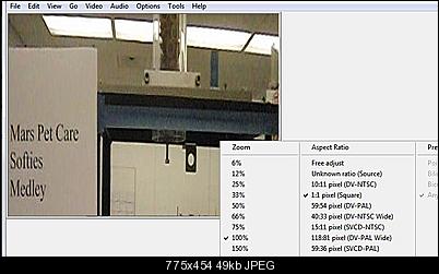

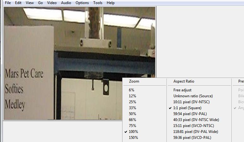

  12. Did you reset the AR? Even though it's a different frame and different shot, the clue is in the stretched letters
    Right click => reset to exact size , and right click 1:1 square pixel . Do this for both
    I can simulate what you see by using free adjust . For example your trainee might have inadvertently bumped the setting

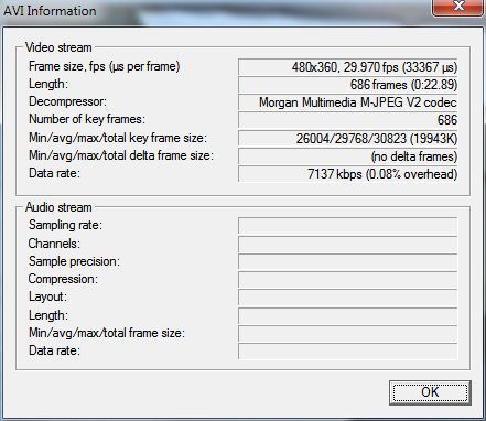

  13. You can uninstall or change the priority of vfw codecs by using vcswap . If the 32-bit version is screwed up, I would start by uninstalling picvideo . picvideo is proprietary and not free .
    If you wanted to use ffdshow, you would disable the other VFW mjpeg codecs that you have installed on your system (perhaps using vcswap), then enable "mjpeg" in the ffdshow VFW configuration (set to libavcodec) . This has to be VFW, not the directshow configuration . These are 2 separate video subsystems. vdub uses VFW

    Couldn't get it to work:

  15. You have to reset it before setting to 100% . The setting is cut off in your screenshot. I'm assuming you tried that first
    Also your screenshots are not 1:1 there is some scaling going on. It's unclear if you are doing this , your screenshot application is doing this, or if vdub is doing this. ie. If this is a 480x360 video, for example your 64-bit screenshot is a lot larger than that. Make sure both vdub versions are reset , set to 100% then 1:1 to start with
    If those display changes don't work , then try uninstalling and swaping out the mjpeg codec mentioned above . You don't have to uninstall it, vcswap can "disable" it so another mjpeg decoder with higher priority can take over. Or you might want to uninstall it completely - it's up to you
  16. Originally Posted by poisondeathray View Post
    This worked!! Putting the codecs to ffdshow has saved the day! Bless you for your persistence with this issue this morning. This is a huge help for me. I just had to disable the Morgan codecs.
  17. Cheers
    Whoops, I though it was Pic Video MJPEG decoder, when it clearly says "Morgan" in your screenshot
    I was thinking that is weird because Pic Video has a decent reputation around here . So it seems "Morgan" was the culprit in your case
  18. I've never seen codecs make a difference like this. We use the videos from this camera all the time, but only vdub has had this kind of problem with them. Anyway, solved now. Again, much appreciated.
  19. Small clarify...
    VirtualDub can decode a few formats (such as MJPEG and DV) using internal decoder.
    If there is no proper codec installed (in system), VirtualDub uses internal decoder (of course only for specific formats).
    In VirtualDub configuration is option to force use of internal decoder - Options > Preferences... > AVI > Prefer internal video decoders over installed third-party codecs (MJPEG and DV)
