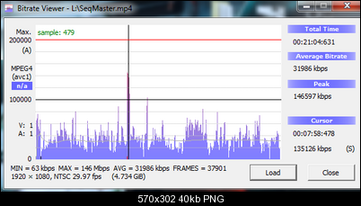

  15. thanks, it a bit small as a tool, I wish I could expand the window to have a greater look at the graph, but regardless it answered my question about the spike as it really have to do with the small freeze I get. I don't understand however in the final video I produced with the h.264 codec, everything is fine except one spot where the bitrate skyrocket way beyond where I specified the max limit. In Premiere, I specify max 40 mbps bitrate and the sequence that freeze in the player jump to 140mbps in the graph! I don't really know how to fix this.

    Yeah but it exactly the problem here, it a huge spike in the graph exactly happening where the slowdown occur when playing. It average 30mbps then a big spike of 140mbps happening consecutively for around 5-6 seconds.
    It looks like Premiere (which I don't use BTW) is using (very-)short GOPs
    With x264 anyway, it's easy to set a low scene-change sensitivity, long GOPs (between 240 and 300 frames, for example), and (as a last resort) specific "zones" (with lower-quality parameters in this particular case).
  19. It doesn't look like Premiere doesn't have any GOP options with H264 codec.
    Here's what it look in bit rate viewer:
    I wonder how to solve this
  20. Fixed by going CBR instead of VBR 2pass. It has even lower file size and smoother play.
