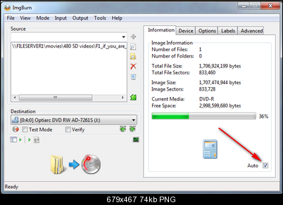

    What I did was open the program and load the file on the left side, then it showed how large the file was in %, on the bar on the left. The I filled the file name and burnt the disc.
    But now it doesn't fill the left bar, so I wonder what I am missing. How should I proceed to setup this now?

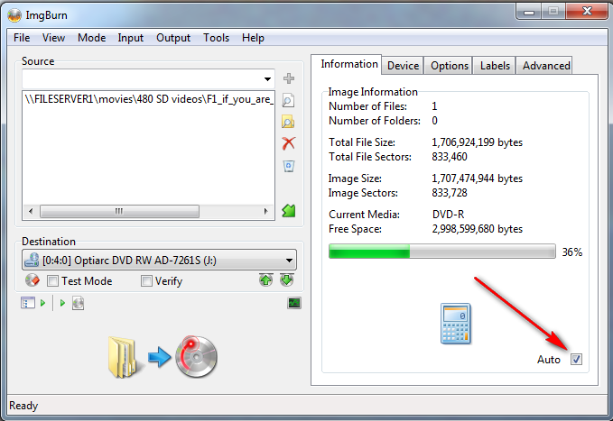

    i don't know about a bar on the left but you have to put a check mark in the "auto" box if you don't want to click the calculate button every time.
