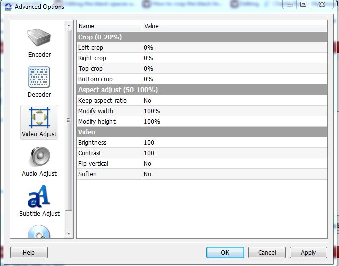

    So, I looked into WinAVI's advanced options and found this:
    Any you guys got any ideas on what I should change?
    (sorry for 2 pictures, for some reason i cannot delete)

  8. Member AlanHK's Avatar
    Apr 2006
    Hong Kong
    I would guess "crop" at the top.
    But, I don't know if the windowboxing is part of your original AVI file, or if it's added automatically by WinAVI to centre it.
    If the latter, it seems you can't do it in WinAVI.
    Unless perhaps it accepts Avisynth input.
    But wait and see if any WinAVI gurus can help.
    thanks friend,
    so yeah, i tried the cropping, the black boxes do not disappear, rather it zoomed in on the top part of the video,
    im guessing my best route is the VirtualDub, i guess ill wait to here from experts on that,
    thanks again
