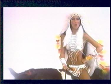

  9. It's like the filter coulourlike in a way but even more simple, i've just tried it with a vhs/dvd source the vhs source looks way better now (very close to the dvd colors). Problem is the pixels must coincide and adjusting that with an interlaced video that's a challenge; i guess i'll deinterlace both sources.
  10. Originally Posted by themaster1 View Post
    So you blended a DVD rip and a VHS rip together?? That could be interesting as well. You got any before/after?

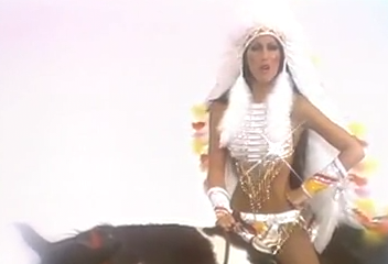

  12. ColorLike() adjusts the RGB historgrams of one video to match the historgrams of another video.
    This script fairly closely matches the brighter areas in your raw video to the youtube video (the bright white shots):
    ColorYUV(gain_y=35, off_y=8) # adjust levels (brightness/contrast)
    ColorYUV(off_u=11) #adjust chroma U offset -- white balance the background
    ColorYUV(cont_u=10, cont_v=10) #increase saturation a bit
    youtube:
    raw video adjusted:
    It leaves the horse blackish. If you want the horse browner, pull down the dark blues.
  13. I believe the horse is black. I'm almost certain...either that or he's extremely dark brown. I think I have this clip on DVD from the all too brief set they put out a few years back of the Sonny and Cher Comedy Hour/Sonny and Cher Shows. If it would help to have it in higher quality than youtube I could rip it from the DVD. That's interesting...I didn't know you could do the "colorlike" trick. Avisynth really seems to be quite the little tool. I mean is there anything it CAN'T do? lol Well except apparently TBC but I took care of that...and to jagabo thank you so much for putting the "#" descriptions in next to each step. Things like that are helping me to learn Avisynth and do things on my own.
  14. I changed the comments in the script a bit. Be sure to reference the AviSynth docs too.

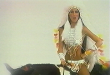

    ColorLike() is a little tricky to use with videos whose framing doesn't match. I took frames 125 from your raw video, and frame 1400 from the youtube video, then cropped and resized them. I built ColorLike histograms from those. Then applied them to the raw video. The framing still didn't match exactly but here's what I got.
    ColorLike to make raw match youtube mp4:
    I didn't bother to clean up the borders for this sample image.
  15. I think maybe this latest example looks a bit more natural than the previous example posted. I don't know though..they're pretty close to my naked eye.

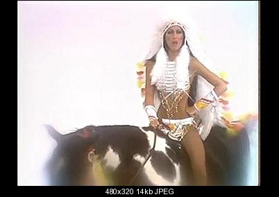

  19. Let me make some screen caps from a few other sources I have of this same clip and we an compare. I have it on VHS from a TVLand broadcast and on the DVD set I mentioned...
  20. I believe this is from the same portion from the "Sonny & Cher Ultimate Collection" DVD set:
    http://imageshack.us/photo/my-images/402/snapshotdvd464820111002.png/

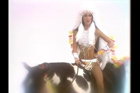

  21. Originally Posted by themaster1 View Post
    http://imageshack.us/f/3/horseg.png/
    with msu old color (91 /8) and colormill
    just figured i'd put it where it'd show up directly in the post...mine cap from the dvd was original a bmp and it wouldn't let me upload here directly then imageshack converted it to png upon upload anyway. go figure
