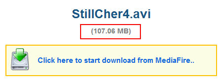

  3. I downloaded from the 1st post in this thread
    http://www.mediafire.com/?wt90x90vht4l1m6
    Mediafire says 107MB
    But in that first post it says AVISource("StillCher2.avi") . That's "2", not "4"....
    Not sure what is going on

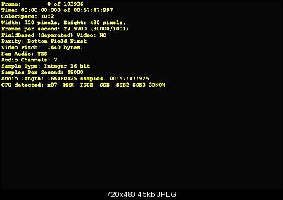

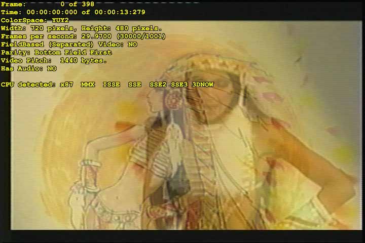

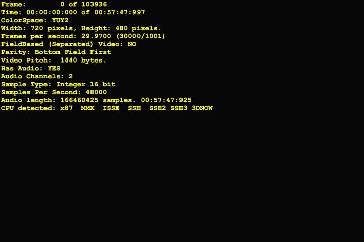

  22. Here are some screen caps from Virtualdub using:
    Avisource()
    Info
ID:	8947Click image for larger version
    The one on the top is StillCher4 raw transfer.avi and the bottom is StillCher2.avi (the untouched raw 60 minute capture)
