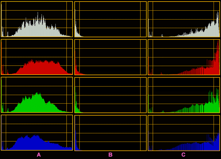

    Usually I interpret a histogram as saying "in-range", "out of range", or "wiped out" as shown below:
    A: In VirtualDub I'd say this image would be "mostly" in-range of 16-235. It's a bit bright, and there's a bit of clipping with the brightest blues. I'd adjust the brightest red and blue because those highlights might look a little "hot" on TV. It depends on the video; some high-key stuff is done that way on purpose. The far left-hand spikes are the frame borders.
    B:
    blacks crushed.
    C: highlights blown away.

  5. Some things to note about the ColorTools histograms:
    1) The 0-255 and 16-235 Source Attributes setting only effect the gray scale graph. That graph shows what the luma levels will be after conversion to YUV. 0-255 specifies the rec.601 matrix will be used to generate the graph (the graph can only extend from 16 to 235). 16-235 specifies that the pc.601 matrix will be used, the graph can extend from 0 to 255 but the values should be restrained between the 16 and 235 markers.
    2) The 16 and 235 markers on the red, green, and blue graphs don't really mean anything. Red, green, and blue data can extend all the way down to 0 and all the way up to 255. If you see a big peak right at the edge it's likely the video is clipping.
    I should have indicated that was for computer RGB. With studio RGB you want the graphs to stay between the 16 and 235 markers.
