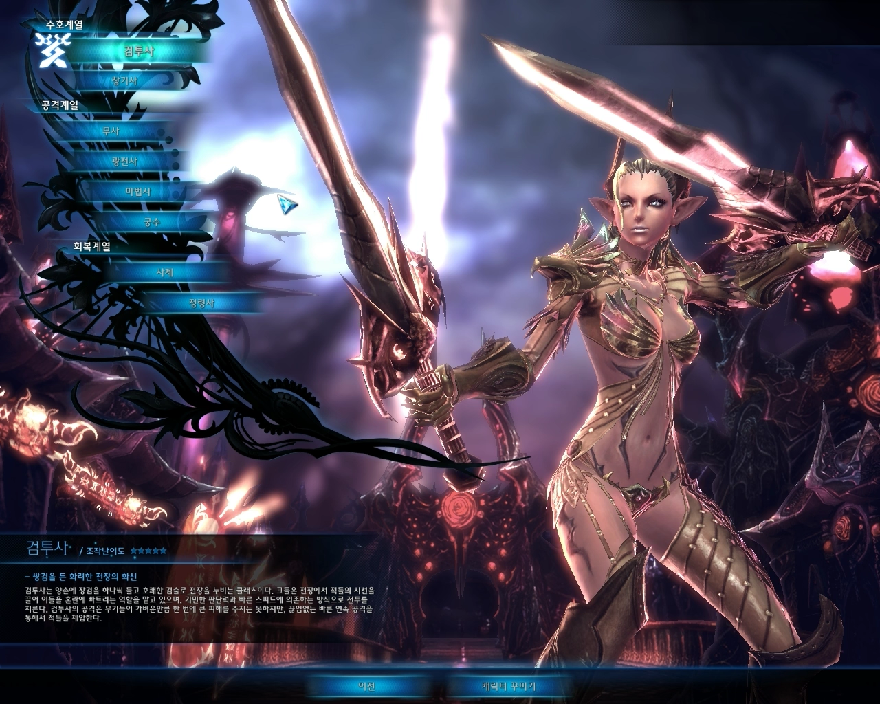

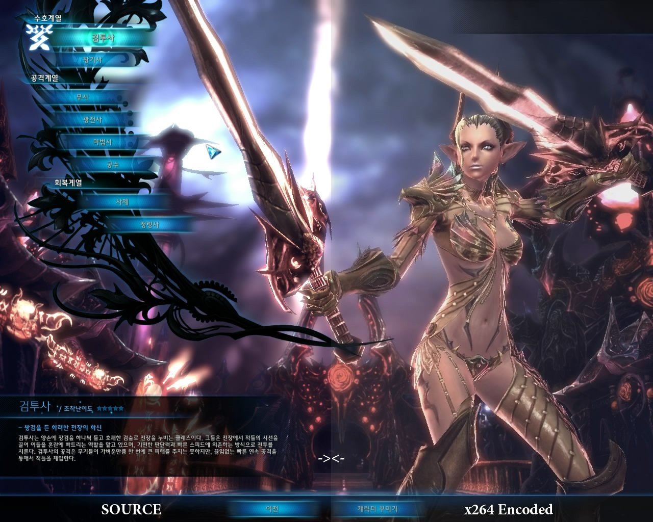

  1. As u can see SOURCE Fraps.avi and Encoded x264.avi files are different.
    x264 - More brightness/lower contrast
    The point is to make Encoded x264.avi look same as SOURCE Fraps.avi with any computer. The goal is to deliver source quality to everybody.
    Please help me with that.
    UPDATE:
    The problem was not in x264 codec itself.
    Fraps decoder always outputs RGB 0-255 (normal)
    Libavcodec (including ffdshow, ffvideosource(), AVISource() IF ffdshow VFW is enabled) will output YV12 full range (abnormal)
    1) Make sure that graphic card configured to use 0-255 and not 16-235 (use graphic card parameters not Player) https://forum.videohelp.com/threads/326496-file-in-Virtualdub-has-strange-colors-when-o...=1#post2022085
    2) Do you have fraps enabled in ffdshow? If so, disable it
    3) you can enable ffdshow, and under the RGB options choose BT601. You might have to configure it so only RGB is selected (uncheckmark other options like YV12, YUY2 etc...)
    This 3 steps is the solution
    Be aware: Most of your other HD videos like movies may not look correct with those settings (colors will be off)
    In that case skip step 3.
    Thank You jagabo and poisondeathray! You both helped alot. (better that any tech support)
    Now both sample1 and sample2 are same with any video player, with 0-255 and 16-235, with any output method. VMR9 or Overlay mixer.
    Image with Problem:

    Yes the x264.avi looks less washed, BUT the source fraps.avi looked even darker
    for example
    16-235
    fraps.avi: 10 brightness
    x264.avi: 12 brightness
    0-255
    fraps.avi: 8 brightness
    x264.avi: 10 brightness
    Ok i cant control what people will see with different Graphic Card settings.
    BUT how hell i can match fraps.avi brightness and x254.avi brightness?

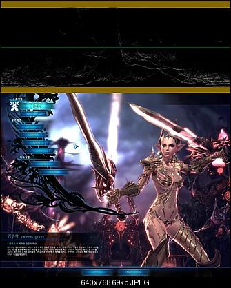

  26. I meant 2 instances of the x264 encode. The 1st will use overlay, the 2nd will use VMR => this is to illustrate that there will be BIG difference in appearance, even though it's the SAME video . The reason is you were using VMR9 . Different renderers and playback settings can cause BIG difference in appearance
    Both encodes look the same to me in terms of luminance (save these to your desktop and switch back and forth so that you view them at the same viewing angle on your monitor, top is video1, bottom is video2)
    It's not an x264 encoding problem; as mentioned from the very beginning - it's a playback configuration issue
    So fine tune your playback settings . Use [search] and read the dozens of threads that tell you how to configure your setup.

  28. Yes, both videos look the same here too. The same as the samples poisondeathray posted. The levels are perfect:
