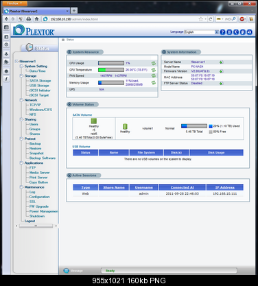

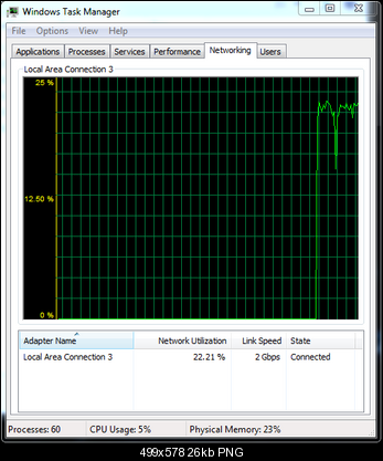

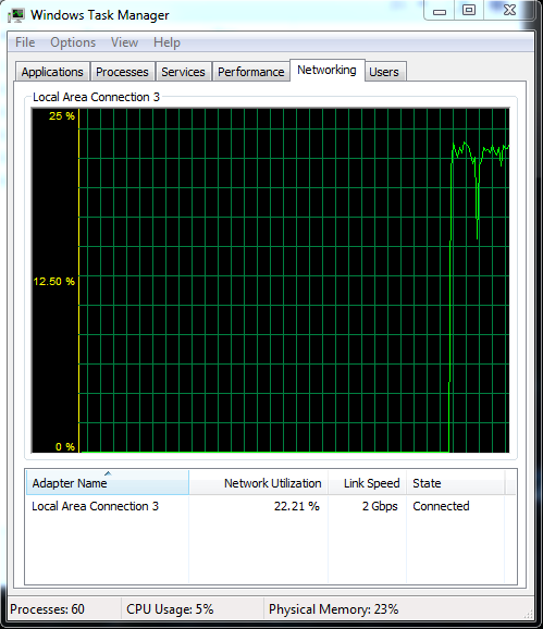

    the transfer speed of the plextors is about 50MB/s(400mb/s). and it has 2 separate nics each with 10/100/1000 speed. to handle multiple downloads simultaneously.

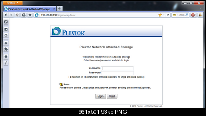

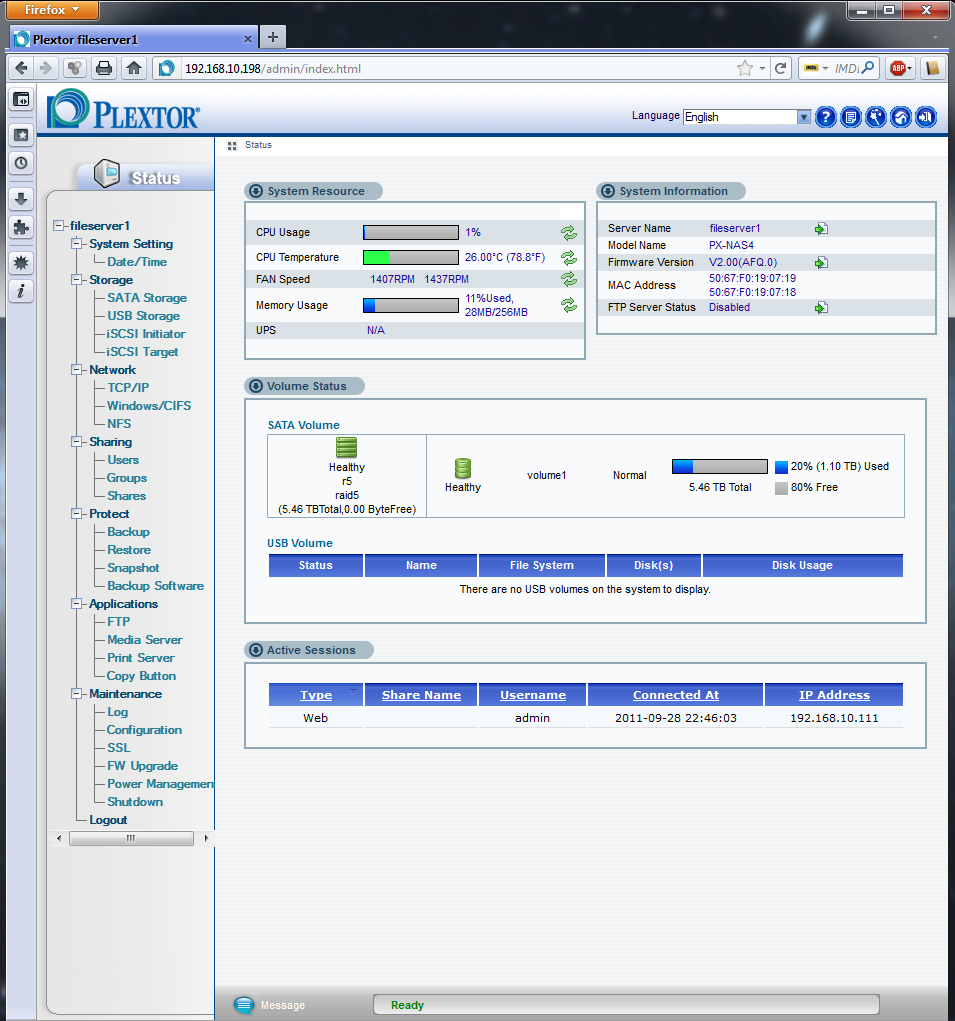

    all nas that i know of are accessible using a browser just like router. here is the plex interface.
