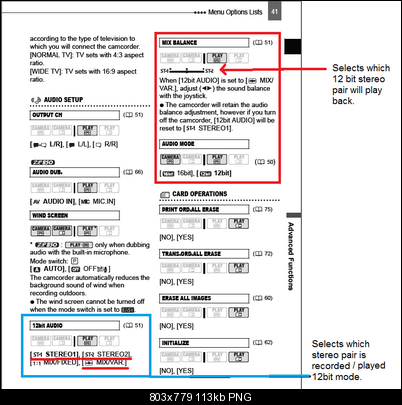

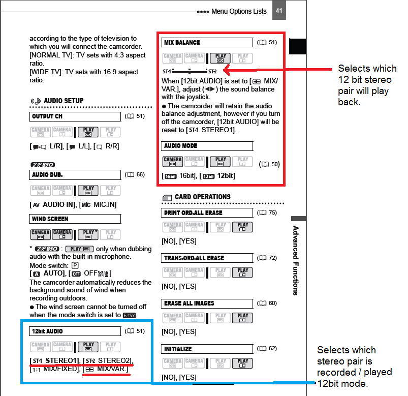

    12 bit audio controls are shown here
    http://www.kiva.org/about

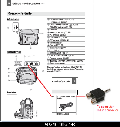

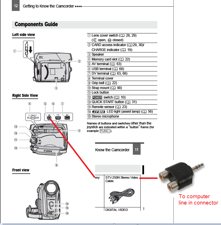

    Just use the AV cable supplied with the camcorder and an RCA stereo to stereo miniplug adapter into computer audio line input. Audacity is good free recording software but you could use Windows recorder.
    http://www.majadu.co.uk/twin-rca-phono-to-35mm-stereo-mini-jack-plug-adaptor-75-p.asp
    [Attachment 8893 - Click to enlarge]
    Thank you, you've been very helpful. I'm going to track down those parts and hopefully report back in a few days with the results.
