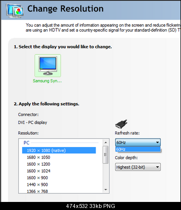

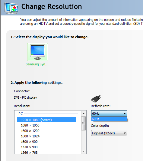

    25 Hz (interlaced) should be = 50i. Maybe that monitor can accept 576i or 1080i. Try them in 25Hz mode.
    Otherwise feed it 50hz from your computer display card and see if it works.
    My Samsung SyncMaster only accepts 60 Hz.
