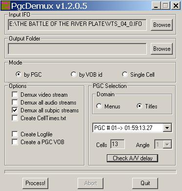

  2. Try getting the subs using PGCDemux. They'll give them to you in SUP format which you can then instantly convert to VobSubs (IDX/SUB) format with SubtitleCreator. I believe that PGCDemux will reset the timings (but not having done it the way you have, I can't be sure).

    You might also open the original IFO for the retail DVD in PGCDemux to check if all 5 episodes are in the same PGC. And if so, you might then check by VOB ID to see if the episodes are divided by VOB ID. If so, I know you can get the SUP files with the timings reset.

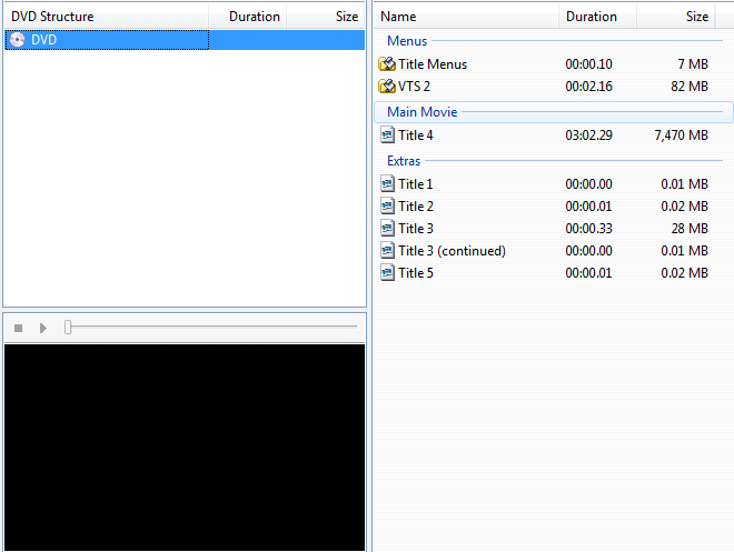

    here is the picture
    BTW...Could you show me how to use the app PGCDemux? Really sorry if that's a noob question.

  4. That's not a picture from PGCDemux. Anyway, open the IFO with that 3 hour PGC of the episodes all together (you were right - they're all together). Rather than using the default Mode 'By PGC', hit 'By VOB ID' and see if the timings it then gives you for the various VOB IDs correspond to the length of the various episodes. Use the drop-down box to help check them. If the VOB IDs don't help, if worse comes to worst, you can modify the timestamps of the various VobSubs using the Sub File Cutter utility that is included in the VobSub package. However, you'll need to know or figure out the total length of all the episodes before the one you're currently working on.
