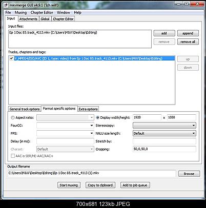

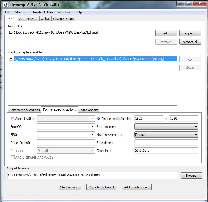

  11. Well i have tried cropping in mkvmergeGui and this does actually crop when i run the video in VLC player. but on my WDTV it looks exactly the same. here are my settings:
    (i assume you can click to open this image!!?)

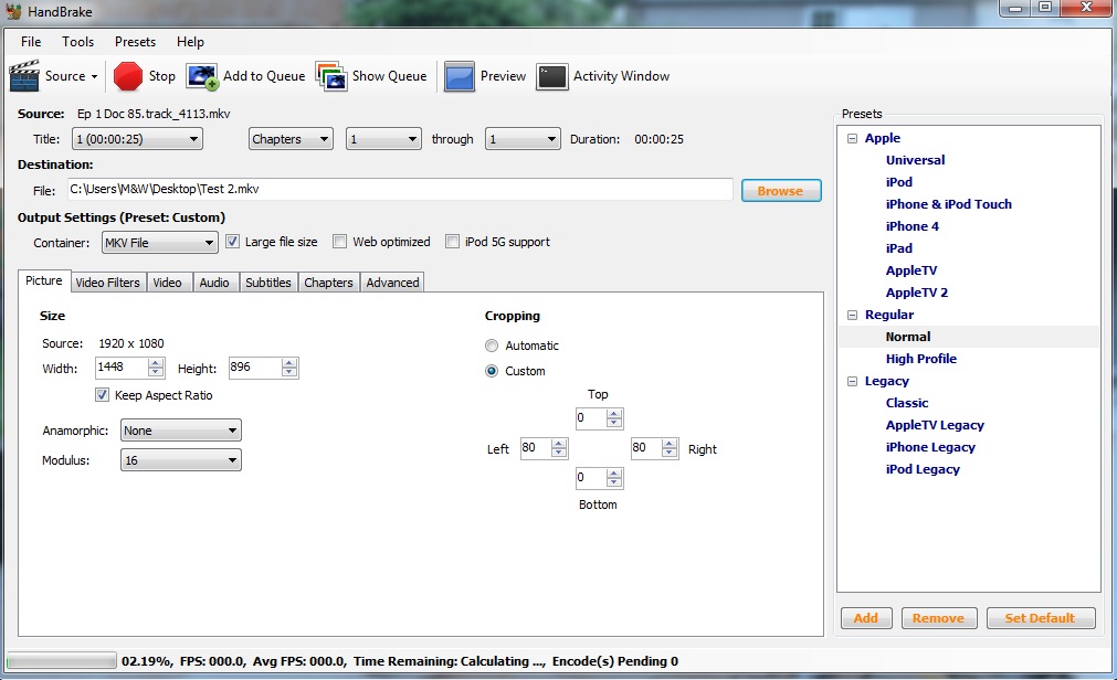

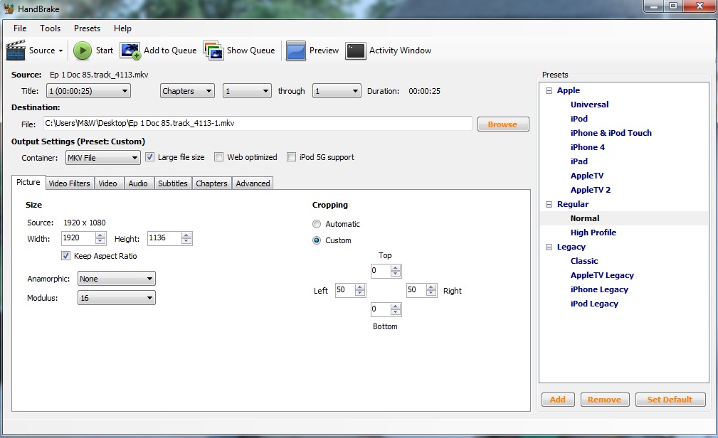

    Now here are my settings in HandBrake using the cropping feature, which actually re encodes the video, as apposed to just muxing the parameters in to the MKV (in mkvmerge)
    HANDBRAKE:

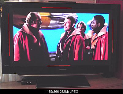

    but heres the outcome on my tv!:
    I have marked out where the tv edges are.. as you can see, it hasn't quite worked as planned. i thought by chopping of some of the edges the TV would automaticaly pull the picture closer and thus losing the black bars at the top.
  12. Originally Posted by marklittlevai View Post
    Enlarge VLC to full screen. The black bars will come back.
    Like I said earlier, the player will restore the cropped borders. It keeps the 1080 pixel image height and adds borders to the edges of the picture to fill out the 1920 pixel wide screen. The player tries to maintain the proper pixel aspect ratio (1:1 in this case).
    Crop both the width and the height and leave a 16:9 ratio frame size if you want the video to fill a 16:9 screen.

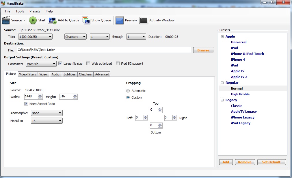

  18. I'm a MEGA Super Moderator Baldrick's Avatar
    I just get an error message that says "invalid attachment" when I click on the links.
    They works fine here....But I don't know why vbulletin shows them as just attachment-links.
    edit: Posting images. It works fine.
Name:	Hand 1 with crop parameters.jpg
Name:	Hand 1 no crop parameters.jpg
  19. The links still don't work for me. I've tried 2 different browsers. But I can see Baldrick's images.
    I don't use that software but it looks to me like you're resizing to 1448x816, not cropping to 1448x816. Just set the top and bottom crops to 132, the left and right crops to 236.

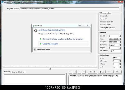

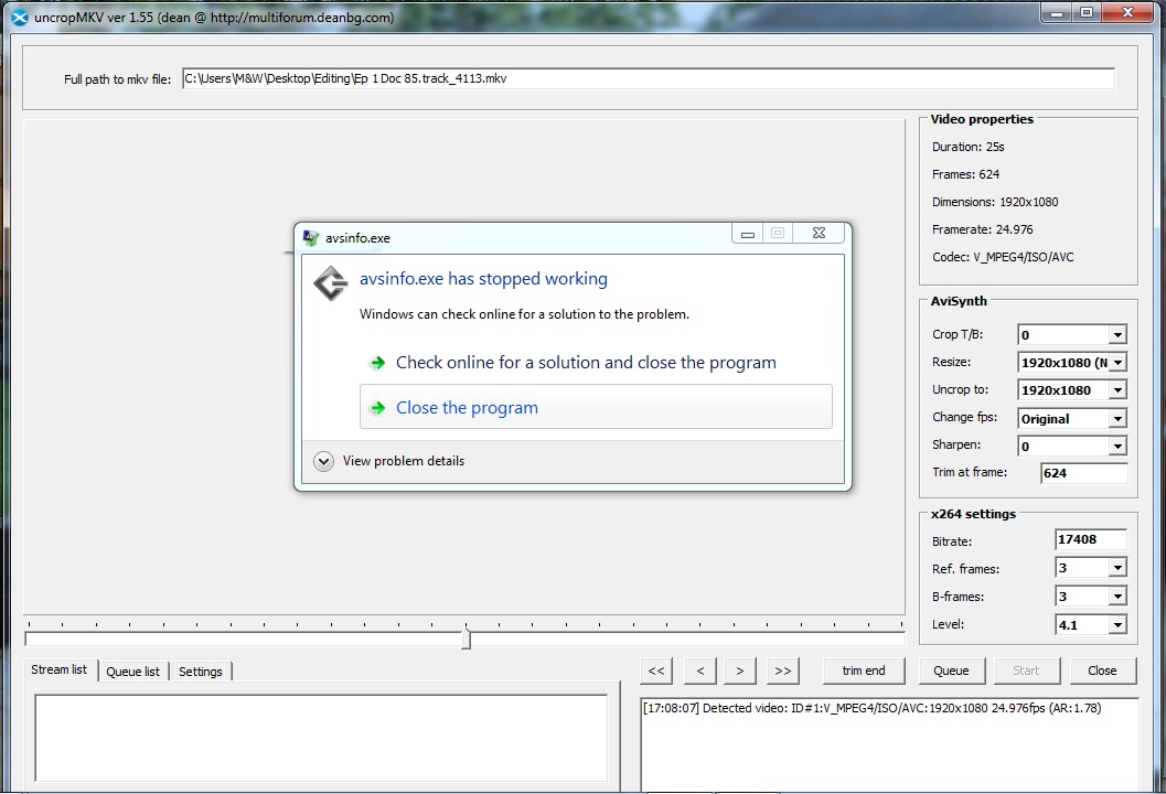

  25. Hi
    I tried uncropMKV on my XP machine, as soon as i opened an MKV, it crashed.
    tried it on my windows7 machine and this happened as soon as i opened an mkv (only a 1 min long vid too!! so not much to load up)
    Guys, thanks for al your help. i might tinker around with it over the next week or so, but it sounds as if it's pretty much NOT a common thing to do out here on the web .. or i'll just wait for these new 21:9 tv's that are coming out, they look great.
