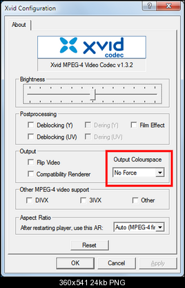

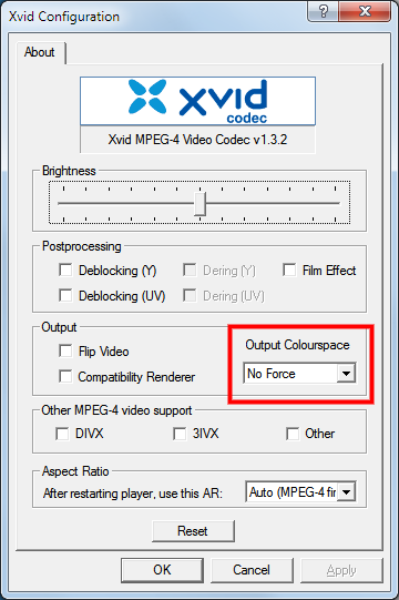

    I encoded it with Xvid.. And yes.. I have Xvid.. But I do not know where to find the Xvid settings or such "Force YUY2"
  13. Originally Posted by NeroLi8gerzid View Post
    Start -> All Programs -> Xvid -> Configure Decoder.

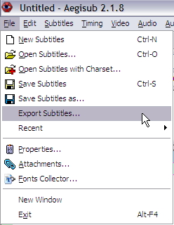

    Aegisub can, indeed, output subtitles to .SRT format. Here's how:
    1) From the File menu, select Export Subtitiles...
    2) From the drop-down list, choose you text encoding then click on Export...
    3) From the drop-down list, choose SubRip (*.srt) then click on Save
    That should do it.
    [Attachment 8849 - Click to enlarge]
    WOW! Thanks mate! Now it opens them.
