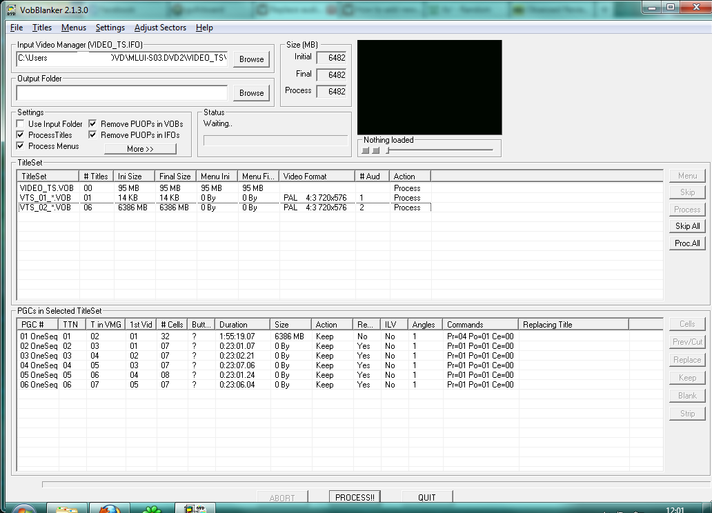

  7. You're a little unclear when you say,"Since I have 5 video streams, I put them into segments, added the .m2v and the .ac3 data as well as the celltime.txt that PCGDemux creates when demuxxing the video stream from the dvd." Do something so we can understand. Open the original DVD in VobBlanker. Highlight the VTS that contains these 5 video streams so they appear in the lower part. Then take a picture and upload it here. Once we can understand how this DVD is structured, we can then offer more informed advice.
  8. Im sorry for being unclear, but Im quite new to this thing and I just dont have the terminology yet. I have the screenshot of VOBblanker loading the main .ifo of the original DVD attached.
    Edit: what I tried to say was: I open up Muxman, select the video and the audio stream as well as the CellTime.txt from PCGDemux and click that button beside the selection box that reads "add". Because the standard names are "Segment_?" I gave you the exact wording in order to avoid confusion. Really worked well, I guess.
  9. OK, as I suspected, the whole thing is in a single PGC/Title. Therefore, to have "put them into segments" was a mistake. Demux the whole thing - all 1 Hour 55 Minutes and 19 seconds - into a single file of M2V, AC3 audio, celltimes.txt and subs (if any). Don't touch the menus (the VIDEO_TS.VOB). Remux with Muxman adding in the M2V, your new audio (for the complete nearly 2 hour long title), the subs, the celltimes.txt, and then use that when replacing. Replace only that first title, the one that's 6386 MB, and leave the rest alone. You can't replace the individual episodes, but only the complete PGC which comprises all of the episodes together.
    If you were to highlight that first PGC in the bottom window and then hit 'Cells' to the right, you'll be taken to a new screen and you can replace the individual cells (chapters) there, but since there are 32 of them, I very much doubt you'll want to do that.

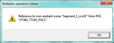

  10. I have demultiplexed the Video and the audio as I was told and just cut the audio from one episode (as a test for a/v delay) into the ~2h audio stream. It works perfect, but Muxman creates a warning/error message in the end while working on Scene 31. I used the celltime.txt which PCGDemus created when it demultiplexed the entire PGC.
    I think this is due to the fact that the cell-counter of the epidodes the VTS_02_* dont add up to the ~2h long PGC cell counter.
  11. Right. Open the celltimes.txt and either completely remove the last line or take that last line and subtract about 40 from it.
    Doing the former will generate a warning from VobBlanker and it'll create a new cell to replace the removed one. Doing the latter results in a last cell a little over a second earlier than before. Either way works.
    As for checking for a delay, if you checked the A/V Delay in PGCDemux and found none, then at least the first episode should be in synch. There's a chance the later episodes might go out of synch.
  12. I have deleted the last line, but the error still occurs. I now have removed the last line od the already edited file as well, so it lacks the 2 last lines from the original one. It is multiplexing right now, and I will report the results.
  13. If you open the original celltimes.txt and count up the number of lines, aren't there 31 of them? The first cell (chapter) is at zero and isn't included.
    If there are more, then something else is at work. Check those last two lines. Are the numbers very close to each other (like within 20 or 30)? Maybe post or upload that celltimes.txt. Also check the log for the total number of frames.
  14. In my last step I have deleted the 31st line. While demuxing, I have checked "include end-time" or something like that. Was that wrong/unwise?
  15. Hehe, you don't want the end time.
  16. Check the LogFile.txt that PGCDemux gives to you. There's a line in it with the total number of frames. Here's one from a movie I'm working on:
    Total Number of Frames=260250
    The last line(s) in the Celltimes.txt have to be at least about 40 frames less than that number.
  17. Kind Sir, I have finally made it. Thank you for your great support.
