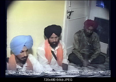

    i was trying to restore some old vhs recordings and was facing the following problems-
    1. White line on the right side of the picture
    2. a lot of grain
    3. colours appears bad
    4. wierd lines appearing at different times, colour lines.
    I am using adobe premiere and after effects for editing.
    If i use the premiere filters to reduce noise then the picture appears very soft on the television.
    Deinterlacing mpeg 2 files also is not having the desired effect.
    can you please go through the video attached and give suggestions as to what steps/filters i can undertake

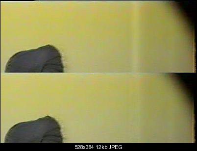

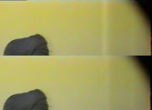

  2. The bright vertical line can be largely fixed by an overlay. Before on top, after on bottom:
    A little more tweaking should be able to do even better. I used this in AviSynth:
    src=Mpeg2Source("02.d2v", CPU=2).ConvertToRGB()
    fix=ImageSource("sub.png").RGBAdjust(r=1.1, g=1.1, b=1.1)
    StackHorizontal(src,Overlay(src, fix, 0, 0, mode="subtract", pc_range=true))
    I didn't see any problems with deinterlacing. What problems were you seeing?

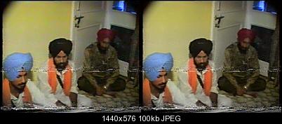

    MergeChroma(last, McTemporalDenoise(settings="very high", interlaced=true))
    before/after:
    For MPG files use DgMpgDec to deblock. Build and index with DgIndex then open the file via Mpeg2Source("filename.d2v", CPU=4) in AviSynth. That will give you good deblocking. You can get deringing too (this video is too blurry for ringing to be a problem) with CPU=6. The above image was done with deblocking (though it was saved as JPG at a low quality setting so some blocks have come back).

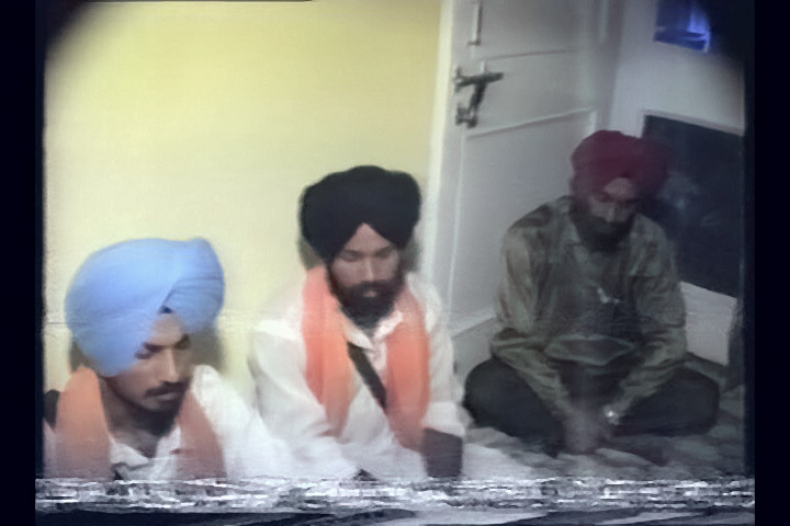

  14. My levels are off and I accidentally rendered it 720x480, oops. Anyway those chroma splotches that were bothering me are gone and the footage deinterlaces well.
