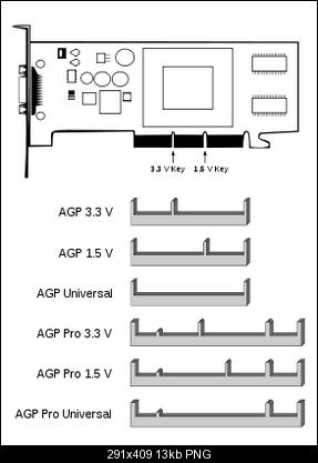

    Yes, it has to do with music actually.. Let's just say that I need to keep an old machine running.. Along those lines, I need to find an AGP 4X video card that supports 1440x900 resolution now.....

    So I don't understand, is it AGP 4X or 2X and does it even matter because I thought AGP was forwards and backwards compatible?

    the terminology is difficult. there is agp(1.0) 1x 3.3v, agp(1.0) 2x 3.3v, agp(2.0) 4x 1.5v, agp(3.0) 8x 0.8v, etc.
    most agp cards before the geforce 6 series will work in either 3.3v or 1.5v slots. it all depends on the cutout keys in the connector.

  14. aBigMeanie aedipuss's Avatar
    Oct 2005
    666th portal
    the card i linked to before has both keys so it will work in either a 2x or 4x board.
