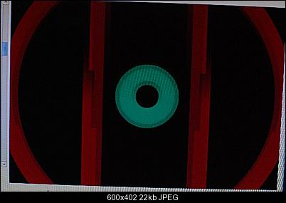

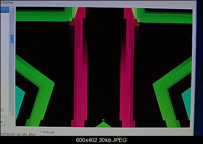

    Nikon D80 1/320sec.
    The vertical bars are moving horizontally away from each other. The problem with the screensaver is noticeable on my CRT and LCD screens, but playing a video with mplayer using the 'xv overlay' only shows the glitches on the LCD.
    Anyway, you'll want to get the underlying driver issue sorted out first.

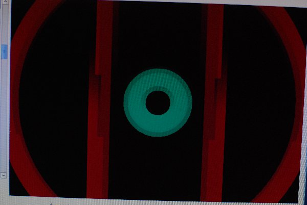

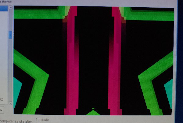

    Ok local video tested and there are no horizontal flashes/lines. There is some distortion, similar to being pixelated which briefly occurs sometimes when a scene changes but that may be to do with the video itself or maybe could be cured with a change in a setting somewhere in VLC. Overall happy!
    Sorry, I meant 'days' not 'weeks' of trawling the web, seemed like weeks! Also, at one point in the process, I had missed out an important step, however, I think Ubuntu should make the process easier to understand. I was going through this thread and just saw your post no. 11 intracube. Never saw it before, sorry! Thanks.
    The resolution with the default drivers was something like 1280 x 1024 before installing nvidia (it should be 1920 x 1200). As I was going to install nvidia, I didn't bother trying to correct the problem. After installing nvidia, as mentioned before, everything is at the correct resolution from the login screen onwards, however, just before that, the 'Ubuntu' and dots that appear are at at a low resolution. Is there a reason why? Should I have corrected the resolution problem BEFORE installing nvidia? I have searched the web and there are solutions for increasing the resolution at startup, however in all my previous Ubuntus, since 6.06, the resolution when 'Ubuntu' appeared was always automatically at the correct resolution.
