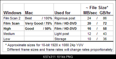

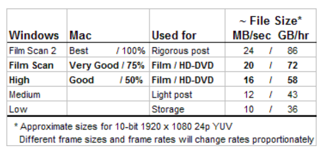

    Quality loss is low and you can control file size vs. quality using the following Cineform chart. As you can see, the Windows version allows two greater compression settings.
    Note that native 24 mbps AVCHD is approx 3MB/sec and 12 GB/hr.
    But you need to focus on the end result. At most settings, conversion to Cineform is less lossy than editing AVCHD directly in Premiere CS4/5 since the full timeline gets re-encoded anyway. CS3 can't edit AVCHD directly so you have no choice.
    The Cineform codec is optimized for timeline search performance and for low generation and processing loss.
