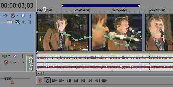

    5. Use software like Vegas to interpolate in-between frames from any of the above frame rates. The advantage of Vegas' Velocity envelope is you can apply variable rate splines to motion for interesting track motion effects (even reverse motion). Disadvantage as you have seen is more choppy slo motion with artifacts especially when using 29.97 or 25 fps source.
    Simple Vegas Velocity Envelope

  3. Thanks for the ideas man I think I understand now. My video camera shoots at 60i and like you said it runs at 29.97 so it looks really choppy when using the velocity envelope in sony vegas. So I converted the 60i video to 60p through sony vegas and used the velocity envelope and it was smooth. I am probably gonna sell my video camera for a 60p one. Thank you very much.

    Yes 60i to 60p can best be done with AVIsynth filters. Vegas will deinterlace 60i to 29.97p then interpolate from that.
    Turns out Vegas does most things better if you externally convert 60i to 60p. In another thread I compared 1080 60i to 480 60i downscale (bad artifacts) to 1080 60p to 480 60i (excellent).
