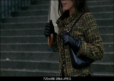

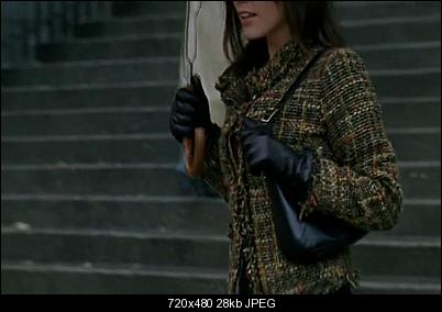

    That works well on panning shots but can screw up with complex motions. Here's an example where it screws up. Three consecutive frames, the two original frames with the motion interpolated frame in the middle:

  8. About all I see wrong is the umbrella bar thing. If that's all, in full motion while watching the video I don't know how noticeable that would be, and I think it looks pretty good. If you had a whole sequence where every other frame was slightly messed up like that, of course that would be more noticeable. One wonders if the motion interpolation of the TV sets or the PowerDVD goodiesguy mentioned earlier can do a better job.
  9. Originally Posted by manono View Post

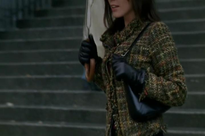

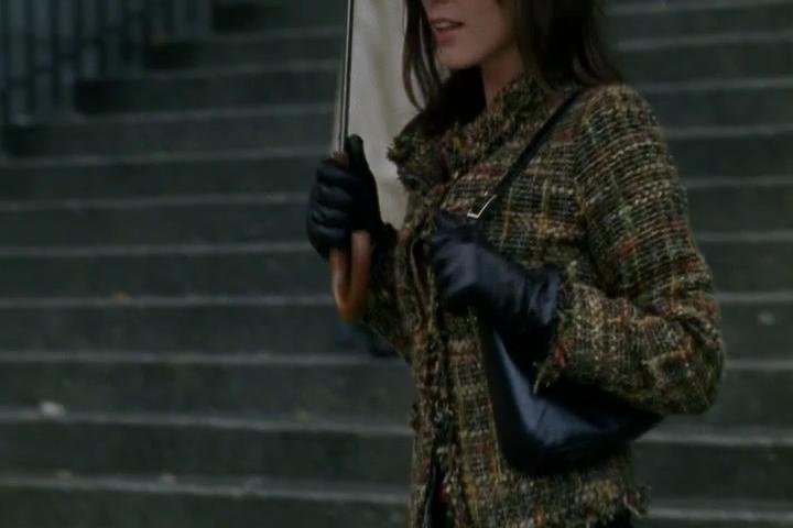

    Not from what I've seen. Though I haven't really looked in the last few years.
    A bad case example (from Tron) is attached. It's usually subtler than this. Usually you just notice that's something's not quite right with the video.
