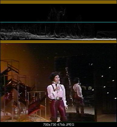

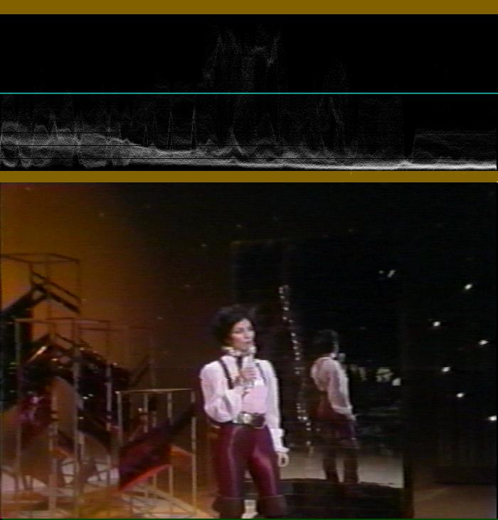

  2. I didn't deinterlace, just picked a frame without too much motion. Here's the script I used to adjust the luma levels and display the waveform graph:
    AviSource("Love and Painasd.avi", pixel_type="YUY2")
    ColorYUV(gain_y=15,off_y=-12)
    VideoScope("bottom")
    It was necessary to use pixel_type="YUY2" because the image height was an odd value.
    You'll need the VideoScope filter if you want to use it. You can get it here:
    http://avisynth.org/warpenterprises/
    AviSynth has a built in waveform filter, Histogram():
    http://avisynth.org/mediawiki/Histogram
    It builds the histogram sideways though. You can get a horizontal histogram by rotating the image:
    Addborders(0,0,0,1)
    TurnRight().Histogram().Turnleft()
    Histogram also clearly shows the illegal luma value areas.

    AddBorders() was used to pad the frame size to an even height. YUY2 requires even width so rotating the image 90 degrees required the frame to have an even height.

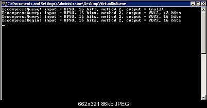

  3. @jagabo how do I convert to RGB using Avisynth...or better yet what is the code? That way I can use Color Tools in VirtualDub until I can further educate myself on Avisynth. Here's the screen that pops up when I use the script sanlyn provided...Thanks again fellas for all the helpful feedback
    AviSource("C:\Documents and Settings\Administrator\Desktop\Love and Pain.avi")
    AssumeTFF().ConvertToRGB32(matrix="Rec601",interla ced=true)
    Also are there software available with Time Base Correction?? I see that Avisynth has some sort of filter for this...
  4. You can open your video directly in VirtualDub. It will convert to RGB with a rec.601 matrix for filtering. If your video had blacker-than-blacks or whiter-than-whites that would cause the regions to be crushed. But your video doesn't have those.
    I'm not sure how you're getting those AviSynth messages. You should start with just:
    If the AVS file is in the same folder as the AVI file you don't need the full path name:
    AviSource("Love and Pain.avi")
    Also try my version:
    AviSource("Love and Pain.avi", pixel_type="YUY2")
    and
    AviSource("Love and Pain.avi", pixel_type="RGB")
    As noted earlier, some codecs don't like odd frame sizes. I would go back to the original 720x480 until you've verified that the odd frame size isn't your problem. What HuffYUV decoder are you using? The HuffYUV codec? ffdshow? Something else?

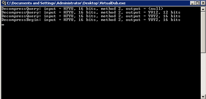

    I tried those tips, other tips, some doom9 suggestions for codec download. All scripts, as well as just VirtualDub's plain old "Open video file") gives me exactly the same results:
    [Attachment 8715 - Click to enlarge]
    I used huff/UYVY some time back, no problems. However, I didn't capture with DirectSHow. I captured with Windows WDM (vfW). I noted in previous post that the OP has WDM as an option. Couldn't he capture with that?
  8. Originally Posted by sanlyn View Post
    I tried those tips, other tips, some doom9 suggestions for codec download. All scripts, as well as just VirtualDub's plain old "Open video file" gives me exactly the same results:
    I'm using ffdshow as my HFYU decoder. Maybe that will help?

    Hm. Last time I installed ffdshow was right after XP Service Pack 3. I could no longer play huffyuv of either RGB or any YUV in any media player, only in VirtualDub. I tried removing SP3, reinstalling ATI's 2006 WDM divers, etc.. No go. So I wiped out XP-SP3 with a DriveImage backup made just before installing SP3. Everything works again (except for this video). I never have problems with VFW, only with DirectShow. I'll make another backup now that everything's working, then install ffdshow again later tonite or tomorrow. Maybe I'm not setting up ffdshow correctly. Thanks, jagabo.

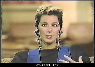

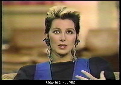

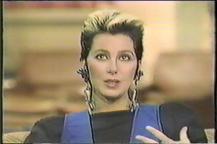

  22. That's a really sad multi generation VHS copy. The levels on that recording are a little tricky. The VHS sharpening filters have caused overshoots. So some areas are artificially darker than they should be. Like Cher's hair. I would go ahead and let those area fall below IRE=0 (Y=16) in order to get the contrast better on the rest of the picture.
    AviSource("Cher2.avi")
    ColorYUV(gain_y=10, gamma_y=-40, off_y=-10, cont_u=50, cont_v=50, off_u=2)
    BilinearResize(180,480).BicubicResize(720,480)
    MergeChroma(last,McTemporalDenoise(last, settings="very high", interlaced=true))
    Before:
    After:
    What you can't see in the still shot is that the chroma is much more stable. Rather than flickering between green and red casts it stays more constant.
    I used a cheap trick to remove some of the VHS haloing. Resizing down, then back up. That leaves the video a bit fuzzy but removes a lot of the halos. If it's too soft for you use a larger size in the first resize. You'll get less effective dehaling though.
    You might go a little further with the levels adjustments. Look at a wider variety of shots.
    I used MergeChroma() to retain the luma noise while applying a very strong noise filter to the chroma noise. I think there's a way to tell McTemporalDenoise() to denoise only the chroma. Or apply different amounts of filtering to the luma and chroma. If so, you could do that instead.
    I don't usually work with video this bad. Maybe someone else has some better ideas.

    [Attachment 8740 - Click to enlarge]
    [Attachment 8741 - Click to enlarge]
    The MPEG below is the video after denoising with NeatVideo. I did very little color work, as the original cap looked pretty good. No sharpening. Even though I turned NeatVideo's filters down to considerably below midrange, I could have turned them down lower and got similar results. VSH looks a little weird with too much noise removed.
    NTSC MPEG2, no audio, 704x480 (640x480 display) , 21-MB
    http://dc273.4shared.com/download/Z4No9VUZ/B_LovePain_NVLP03B.mpg
    I tried a little work in YUY2 with an AviSynth filter (mvtools), trying to clean up some of the distorted frames. In some cases mvtools helped, in others it didn't help much, and in some places it looks a bit worse (you can't interpolatge new frames from other bad frames. All you get is "new" bad frames.) In some spots you have 4, 5, or 6 bad frames in a row. A line TBC would have helped enormously. MvTools could have been used in the original YUV stage before going to RGB, probably without the slight color shift I noticed from RGB->YUY2->RGB. Unfortunately, you have to denoise a video before resizing (resizers sharpen everything, including noise) or trying to repair bad frames.
    http://dc390.4shared.com/download/eWyIEOZ7/C_LovePain_NVLP03Bmv.mpg
    Some of these bad frames can often be ameliorated on old tapes by repacking the tape before capture. Use a slow-rewind VCR and wind the tape to its end. Then rewind to the beginning. You might have to do this twice. The idea is to get the tape evenly rewound onto the feed size, for smoother transport on playback. You'd be surprised how often it helps.
    The mvtools script I used is attached. There are many members here who are more expert with mvtools and chroma cleaners than I am. They'll have more and better ideas.
