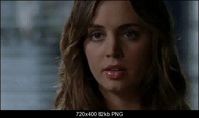

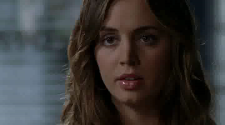

    An extreme example of blocking artifacts (from over compression with Xvid):
    After deblocking (with Xvid's optional deblocking filter):
    h.264 deblocking will not remove blocky artifacts that are in the source video (maybe occasionally by happenstance). Those are considered part of the picture by the encoder. It will in fact attempt to retain the blocks. So you should remove them before encoding.

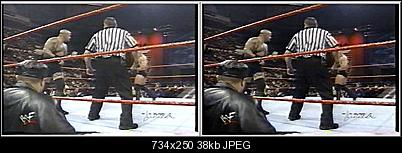

    Black level is a measure of how black the darkest parts of the picture are. The darkest part (overall, not necessarily every shot) should be black, not gray. Original image on the left, more appropriate black and white levels on the right:
    Notice how the dark areas are now black and there is a little more detail in the bright areas.
    Macroblocking refers to the blocky artifacts covered earlier.

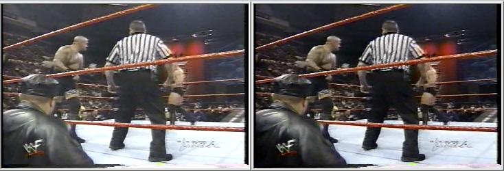

  30. Mpeg2Source("Test File RAW December 30 1997.d2v", CPU=6)
    ColorYUV(off_y=-24)
    McTemporalDenoise(settings="low", interlaced=true)
    Trim(0,800)
    Encoded with HcGUI, 8000 kbps average, 9000 kbps max.
