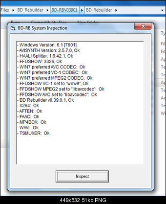

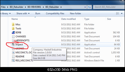

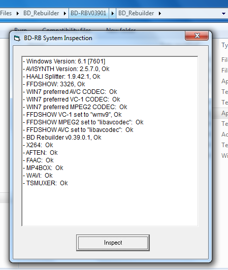

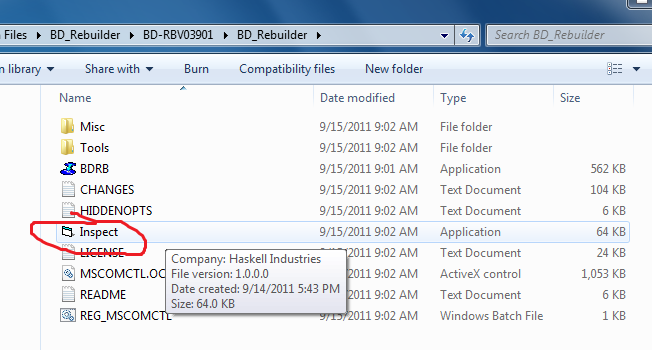

  10. Run the inspect tool in the bdrb folder.
ID:	8659Click image for larger version
    Everything should say ok. You maybe using a non approved version of ffdshow, haali splitter, or avisynth that maybe corrupting the video.
    Also update to the latest release of bdrb. It's currently 39.01

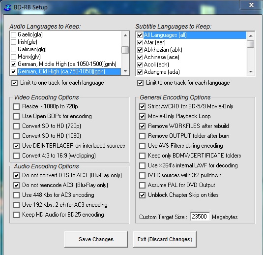

  14. bäm! it works
    I used this time a maxell BD-R (cheapst I found, 2.99€ )
    changed a few settings
    and change the encoding from One Pass (CRF) to One Pass (ABR)
    also I added the folders one by one and used the newest Haali and BDrb
    thanks a lot for your fast help
