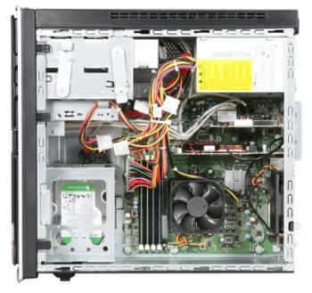

    You may want to get a PC service shop to help you with this. HP/Compaq like to go non-standard on many parts.
    It looks fairly standard but a good PC tech would be able to find a replacement.
    http://www.fatwallet.com/p/desktop/desktop-computer/hp-pavilion-elite-hpe-510t-desktop...0-quad-core-1/

    i hope that's not the inside of your hp pc. have you tried to fit a cs5.5 capable card in there? it looks way to short.
    Jul 2006
    Yes, that's the inside all right. Very crowded.
    I recently had a Firewirecard put in so now there's only 2 pci-e slots left (1x).
    I upgraded the "stock" video card to a NVIDIA GeFORCE GT 440 which I'm told is/should probably be CS 5.5 compatiable which remains to be seen until I have enough power.
    Is it possible to find out what HP actually put in there?

    Should be spelled out on the label. But that won't help with a double power replacement in the same form factor. A good tech could help with cooling as well.
