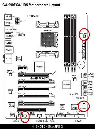

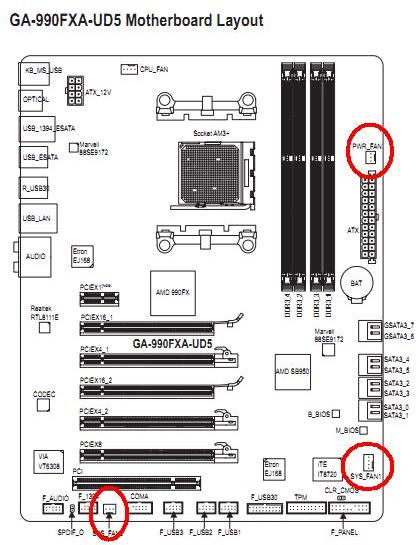

  5. Mod Neophyte redwudz's Avatar
    USA
    I only see three case fan connectors on that motherboard. One Pwr fan, and two Sys fans. The MB manual says the same thing.
    But it's easy enough to use a fan splitter cable and hook up the side fan to one of the other fan connectors.
    Or just use a four pin molex (Power supply connector for IDE drives) to fan adapter.

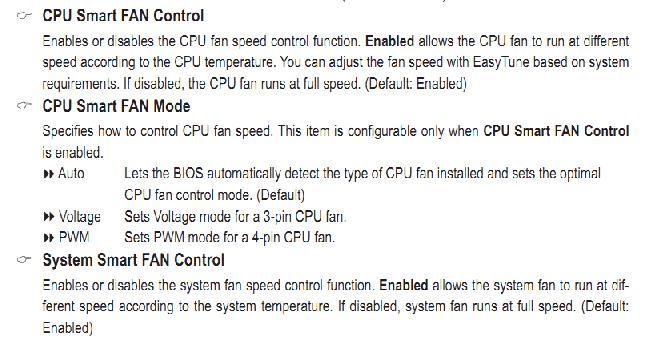

    I see this in BIOS:
    Sorry maybe a bit hard to read.
    If you haven't done it, I would probably also set the CPU fan to PWM (Pulse Width Modulation) control. You can do that in BIOS. It's a much more efficient mode of fan control.
    And if all three of your case fan connectors aren't working, then I would agree with a RMA. But I would also check in BIOS to see they aren't set to some mode that might disable them.
