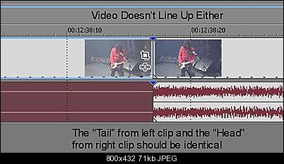

    Ungroup the audio, trim the bad part, then hold down ctrl and stretch it back out.
    OR
    Trim the video back.
    When you time stretch audio in Vegas, it maintains the pitch, whereas simply stretching it in an audio program will lower the pitch and then you have to tweak that too.
    In the case that you want to join sequential clips seamlessly, you have to drill down to the frames level and make your join by ear.

  6. Member budwzr's Avatar
    Apr 2007
    City Of Angels
    "...the result is crappy"?
    What's that supposed to mean?
    There's only 13 frames missing audio. At 30fps, that's only about 1/3 of a second. Splitting that section off, and stretching the source 13 frames is NOT going to be an audible difference.
    The video needs to be patched first so there's no "jump" where the recording stopped and started. Use that stub you clipped off as filler and blend it in using pan/crop and track motion.
    Convert the audio to PCM if it's compressed.

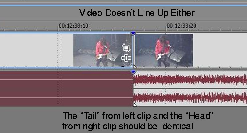

  8. Member budwzr's Avatar
    Apr 2007
    City Of Angels
    What I meant was that the two video thumbnails that come together don't seem to match perfectly. You're drilled down to the frame level and the two ends don't match. At the frame level there's not going to be much visible difference between frames, but you have quite a bit.
    [Attachment 8687 - Click to enlarge]
