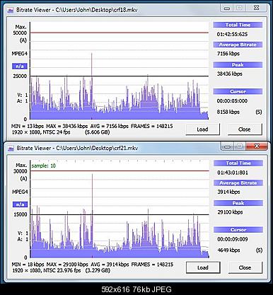

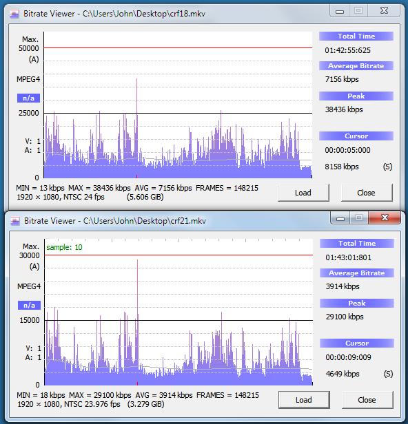

  15. Remember, that's one particular movie (and it partly consists of black borders which compress very well). Different movies may vary by 2 fold or more.
    You have to stop thinking in terms of bitrate being proportional to quality. For a particular movie the more bitrate the better the quality. But different movies will require different bitrates to maintain that amount of quality. You should try sample encodings and see what quality level you're happy with, then encode all your movies with that quality level*. It doesn't particularly matter what movie or clip you use as a test. A particular CRF value will give the same quality with all sources. A particular bitrate will give different quality with different sources.
    Think of CRF and QP encoding as specifiying how much detail you want to throw away. The more detail you throw away the worse the video will look but the smaller the file will be.
    Bitrate maps of the two encodings:
    Note the vertical scales are a little different. By the way, those encodes took about 75 minutes each.
    * Of course you don't have to encode all your movies at the same quality level. On some you may choose to use a lower quality because you don't care about the picture, on others you might use a higher quality level because you care more about the picture. But get a feel for what the range is.

    in the crf 21 encode, it looks like the max bitrate is capped (compared to the crf 18 encode)
    No. More information was thrown out for the CRF 21 encode so it's peak bitrate was lower.

  25. I've tried comparing CRF and 2-pass encodings many times (ie, create CRF, make a 2-pass encoding with the same average bitrate) and haven't seen significant difference it dark areas. Or anywhere else for that matter. Do you have any examples?
    The difference may not be in the actual application, but given enough bitrate, the blocks go away. The movie "Heat" from 2:00:22 to 2:00:51 while the 2 gentlemen are riding in the elevator. The elevator back wall was a mess of blocking until I hit 2-pass at a file size of 28GB. Even at CQ=12, the blocks would still not go away. Had some similar problem with night scenes in the Bourne Supremacy.
