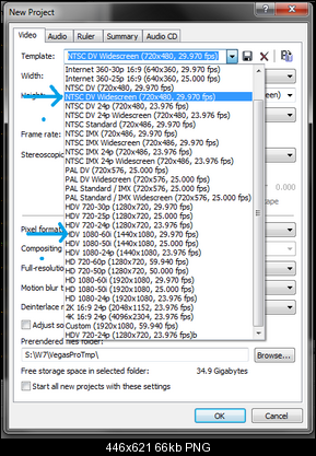

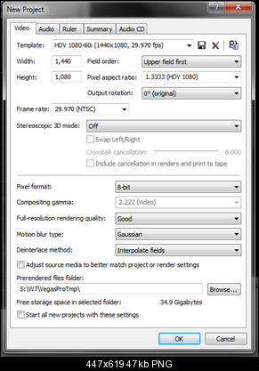

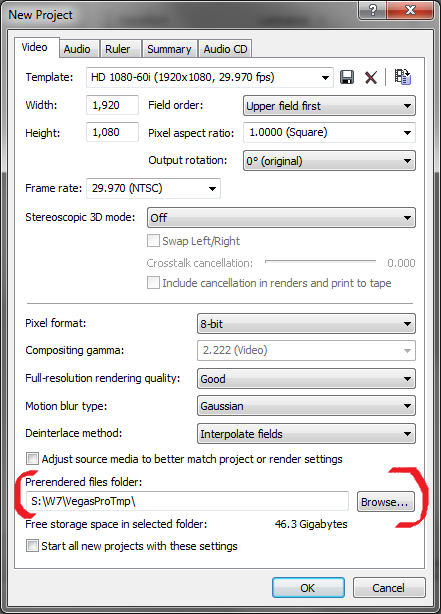

    DV and HDV are both 25Mb/s (3.5 MB/s) data streams so don't stress the capture drive too much. Just don't do any disk operations on the D drive while capturing.
    Uncompressed SD will stress the D drive. Most people use the Huffyuv codec to lower the bit rate.
    In Vegas Pro you set the temp folder in project settings.
    [Attachment 8641 - Click to enlarge]
    What about Field order with SD- or HDV?
    And also check the box for adjust source media to better match project.....
    I do have a question about vegas pro as compared to the best vegas other than the pro. I think it is vegas platinum suite or something. I talked to them about this and they said it is basically the same thing with the same engine except that pro can use the cuda from Nvidia. What can you tell me on this?
    I have Pro 9 and need to upgrade but was wondering if for me the platinum suite would be enough. Your take? Thanks.
  20. Member edDV's Avatar
    Mar 2004
    Northern California, USA
    SD and HDV capture.
    What about temporary file folder in preferences? Where to?

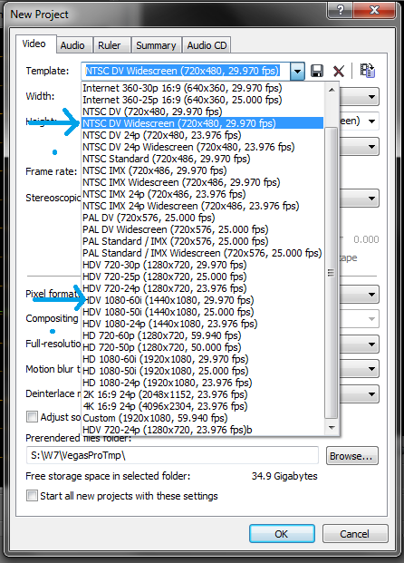

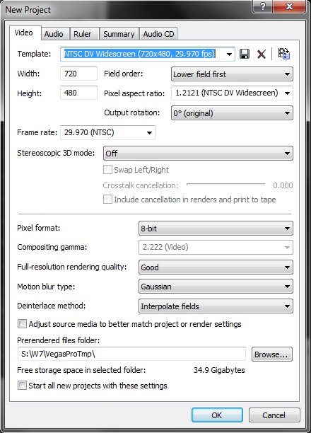

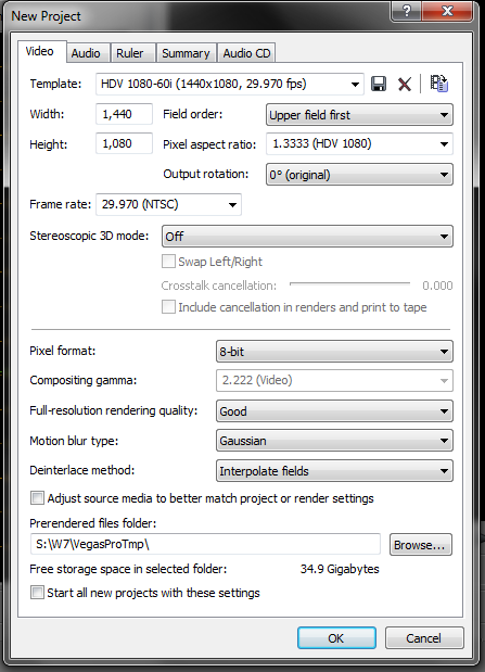

    What about pixel aspect ratio with SD- or HDV?
    DV wide will be lower field first, PAR =1.2121
    HDV will be upper field first, PAR = 1.3333
    Select the project template as shown. Both will default to "blend fields". Change that to "interpolate fields".
    DV Wide should look like this
    HDV should look like this
