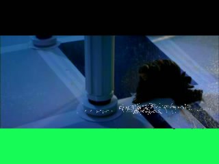

    Fourth off, after experimenting with reference frames, I encountered another bug, which I meant to mention right from the start, but forgot. There are a lot of blocking artifacts as well as discoloration that appear out of nowhere, and this is only on AVC videos. Sometimes I have even noticed it in the black borders above/below a video, even when the source was not anamorphic (I tend to letterbox everything using the "Black" aspect ration correction option inside XviD4PSP 5). I wish I could make a screenshot of what's happening, but the artifacts do not appear on my computer. So, I have placed a badly photoshopped version, to show what I am talking about.
    Name:  Star Wars Episode II - Attack of the Clones.mkv_snapshot_01.02.03_[2011.09.27_17.45.35].jpg
    Notice there is a bunch of green at the bottom, and spots of grey in the middle? If I were watching the video with my device, the grey spots would be square-shaped (GIMP would only let me create round dots), and would change position on the screen based on the motion that is taking place. It must be a motion-decoding bug, since these artifacts tend to suddenly disappear (the video probably reaches an I-frame). Then there is little to no distortion for a while (sometimes never).
  10. The green bar at the bottom is often a result of a decoder that requires certain frame sizes but being given a video that doesn't conform to those requirements. Eg, a decoder that requires mod 16 frame dimensions but being given a mod 2 video.
