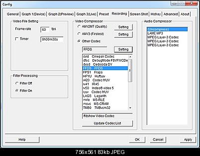

    For EASYCAP and Windows 7 (32 or 64 bits) use AMARECTV. Will play and record fine.

    If you want to try something that uses a bit more compression, AmaRecTV allows the use of Cedocida DV, if it is installed. The problem is that capturing with a codec that is highly compressed for small file sizes often leads to dropped frames because the CPU can not keep up.

    I read your tutorial and tried the FFDS codec, only the file size is huge. (100mb per minute) Which codec do you recommend that has good quality and not too big file sizes?
    Hi Majora,
    I prefer record with UT video Codec. Bigger files, but better quality. After record I use RIPBOT264 to encode for short files.
    Cedocida have some trouble with AmarecTV (the record stop with some seconds or minutes capture). FFDS DV codec is stable with AmarecTV.

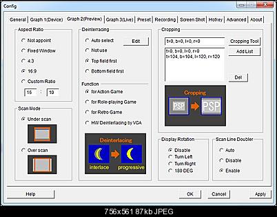

    One tip: In AmarecTV "card options" select Deinterlaced, on Record tab, check "Filters on". Your captured file will be progressive.
