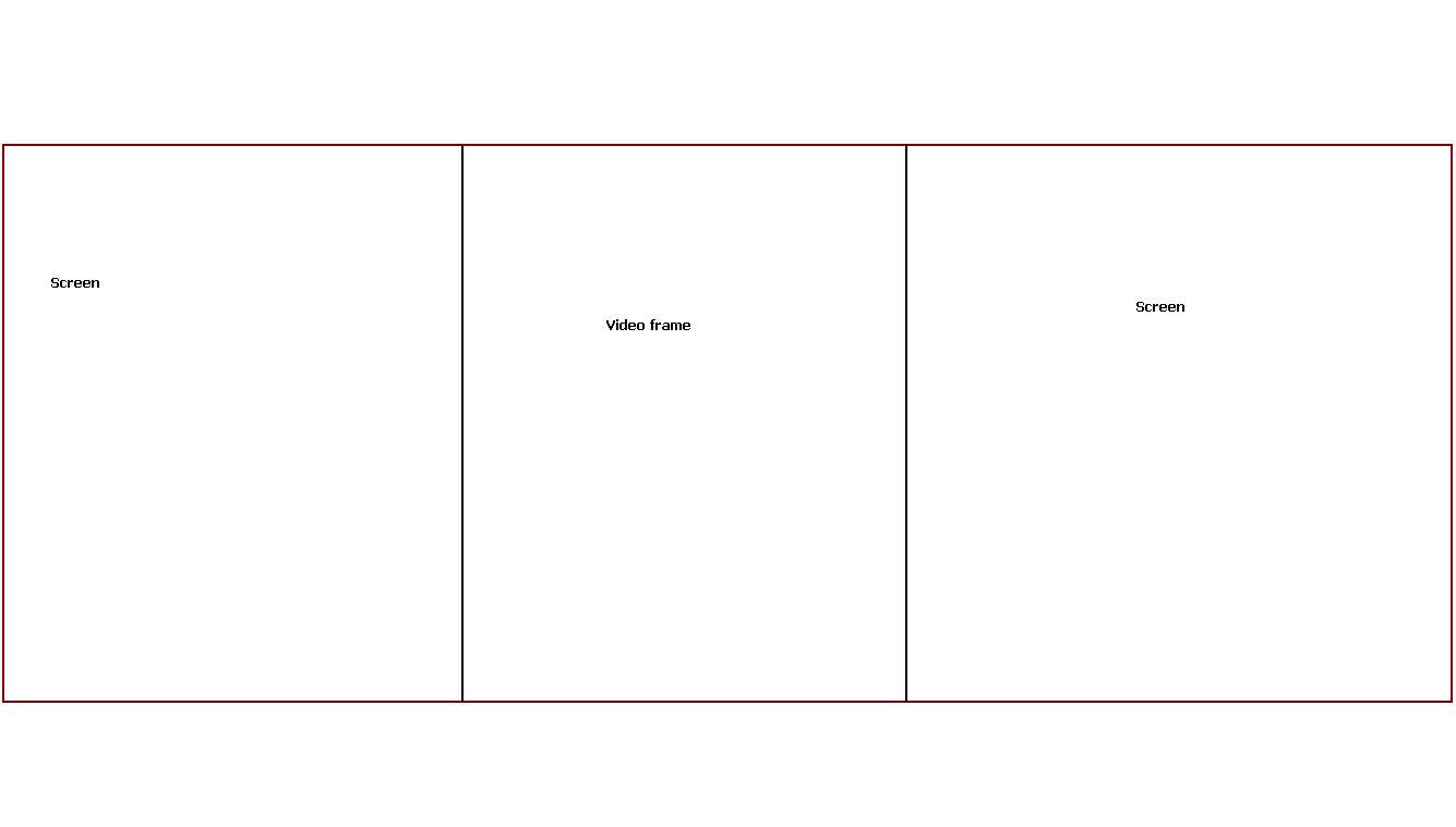

  1. I created a DVD of home movies but somehow I messed up the conversion and what I have is a screen that's sort of like 9:16 aspect ratio, that is the frame is skinny horizontally, but extends across the top and bottom of the screen. It is squished.
    I have the all the VOB etc.. files for the dvd on my hard disk but I don't have the source anymore.
    Is there any way I can convert this back to a normal aspect ratio??
    Thank you!

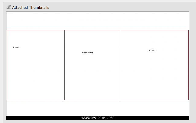

  3. Alright here are the files of the media info and an example of what the frame looks like onscreen.
    I tried running ifoedit on it to change aspect ratio from 4:3 to 16:9 but it did not work.
    In Ifoedit I selected the aspect ratio setting and changed to 16:9. Maybe I missed something else?
    Or is that even the problem here?
    Thanks for your help!

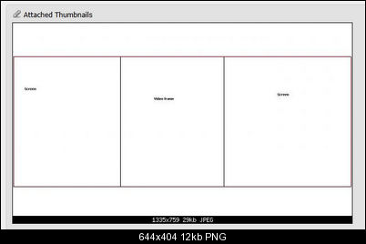

    hard to tell.
