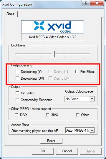

Regarding computer vs TV viewing: the xvid decoder on your computer may be using a deblocking filter. Stand alone players usually don't have deblocking filters. For example, Xvid's decoding options:
Thanks jagabo. I don't normally concern myself with DVDs, it's just the odd TV program that I like to archive but in a reasonable file size. Good news though - using xmediarecode again, I manually specified a frame width of 624 and a bit rate of 1000. There was no sign of xvid decoding options in the style you posted but as you can see, I AM using xvid and there is a deblocking option. This must be a feature of xmediarecode as you can choose deblocking no matter which video codec is selected. Anyway, I chose medium deblocking and, with the other specs referred to above, ended up with a video that plays fine on both PC and TV.
Thanks again.
The deblocking options you show are filters applied to the video by xmediarecode before encoding. You should use that if your source has a lot of blocking.
To get to the Xvid playback deblocking options go to Start -> All Programs -> Xvid -> Configure Decoder. That controls the deblocking while the video is being played. The media player must be using Xvid to decode the video, not some other MPEG 4 Part 2 decoder. -

The xvid deblocking options have nothing to do with encoding. They are applied during playback, and only when Xvid is being used to decode the video. The WDTV live uses a hardware MPEG 4 Part 2 decoder chip. It doesn't have any deblocking features.
