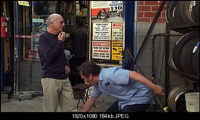

  19. The last clip ..11_41_12.M2TS looks like a full 1920x1080 channel. There are lots of MPEG compression artifacts -- but those are probably in the cable/sat broadcast.

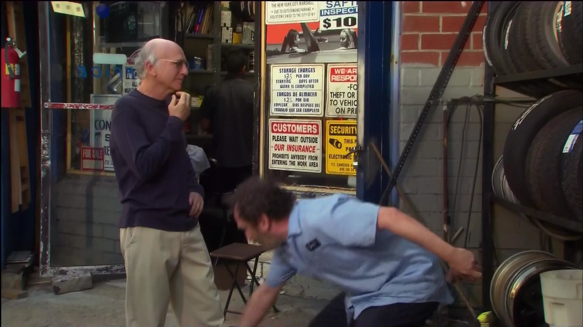

    Oct 2010
    Toronto
    Better example. ive included two pics. The first one is what i see on my screen in realtime. the second is the file i end up with recording it and saving it to my hard drive. I cant figure out how it ends up like this.
    http://movies.adailymovie.com/Sample1.jpg
    http://movies.adailymovie.com/Sample2.jpg
    notice how bad the second one looks.
  21. Is your monitor even vaguely calibrated or is it still running with the same defaults it arrived with?
    I think one of your problems is probably with the de-interlacing in VLC. The first clip looks a LOT better in MPCHC using ffdshow than it does in VLC on my screens.

    The video that comes from the HD PVR is already h.264 encoded. Whether you put it into a TS container or a M2TS container shouldn't matter -- it's still the exact same video. You have a playback problem, not a HD PVR recording problem.

    not usually. I know you think its a media player problem, but it seems more of a hauppage problem to me. keep in mind i can view in fine in the arcsoft player when im recording, it just looks messed up after i end up with the file when its done.
    No. It's the exact same data. The video arrives from the HD PVR already compressed. The ArcSoft Capture Module simply writes that compressed data to the TS or M2TS file while at the same time decompressing it for display.
    To view the videos I posted you should set the graphics card to output 1920x1080 to your 1920x1080 monitor, then view the video full screen (double click on the VLC window to switch to full screen). That way you will get pixel-for-pixel mapping and a perfectly sharp image like the sample I posted. Your sample images are showing moire artifacts from resizing.
