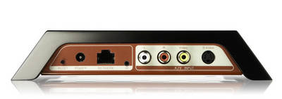

    Slingbox! That should do the trick. I'm looking at the Slingbox AV on ebay. Cheap and simple. The AV has composite inputs on the back so I can use any video source, which would be great if I ever decide to set up some sort of spycam.
    EDIT:
    If I really want to be a cheap bastard, I can get a Slingbox "Tuner" which has a coaxial input instead of RCA composite. Since it takes the old analog signals (here in the US we switched to digital last year) they're going for fairly cheap on eBay. Have the coax output from the digital converter go to the Slingbox Tuner and let it do its thing. It has some sort of IR probe that lets the user change channels from afar.
    Attached: The Tuner versus the AV. Whichever I can get cheapest it the one I'll go for.

    You may or may not be able to change channels with a Slingbox. If the Slingbox has a remote learning function it will be more likely to work for changing channels on a converter box. If Slingbox pre-programs their products with the remote control codes for the set-top boxes used by various cable and satellite provider that is a different story. I have only heard of a few converter boxes that use the same remote codes as those used by one of the other kinds of set-top boxes.
    [Edit]Since the Slingbox tuner is an analog tuner, it won't control your converter box. When it changes channels, it only changes itself, and that would disconnect the converter box, which has to be set up to use analog channel 3 or 4 for coax.

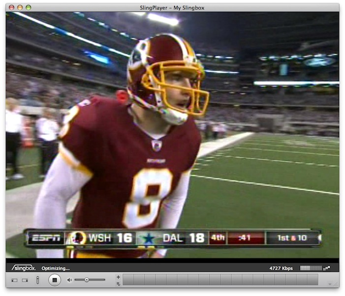

    This is what it looks like.
    She has a decent connection for now. I have my Comcast Cablebox connected to the SlingboxAV. I wish it has pass through connectors though. However I have a composite amp/splitter so it seems to work fine.
