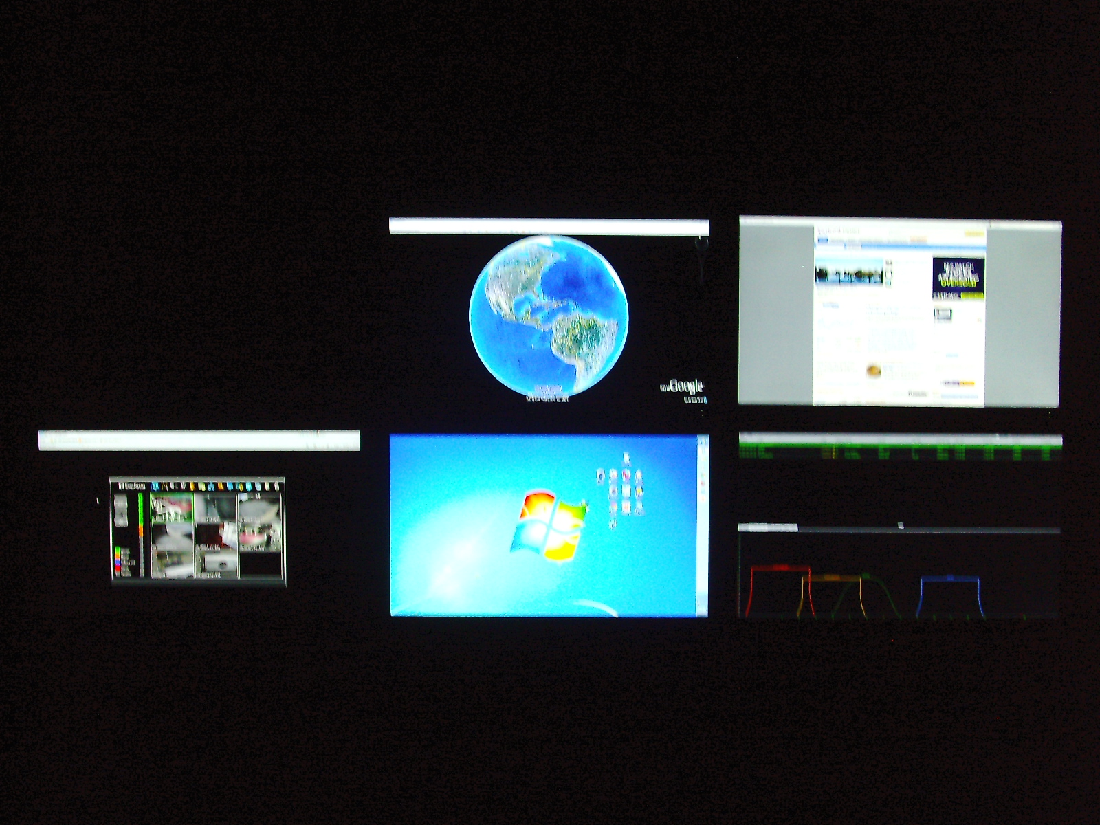

    Here is a pic from tonight.Image
    [Attachment 8722 - Click to enlarge]
    One of the user reviews I saw said a three monitor configuration did not work with this card, going back to that page again I see one from a different customer that says the card is being used in a tri-monitor configuration and it works fine. I forgot about the conflicting report. I guess I'm wrong. Three monitors can work with the Firepro 2460, at least for some people.
    ATI only claims the Firepro 2460 is able run four monitors using four of the MiniDP to singlelink DVI adapters provided with it, or using 4 display ports. Perhaps installing the MiniDP to HDMI adapters prevents the Firepro 2460 from using the MiniDP to singlelink DVI adapters provided with the card on the remaining MiniDP ports.
    Symmetry seems to be important with this card. The Firepro 2460's Datasheet http://www.amd.com/us/Documents/ATI_FireMV_2460_datasheet-LoRez_48119-D.pdf says this:
    Important: When using Mini DisplayPort-to-singlelink DVI adapters, quad output is divided into two pairs (displays 1 and 2, and displays 3 and 4). The displays used in each pair must be identical (with the same manufacturer and model number) and must be identically configured (with the same resolution). The pairs do not have to be identical to each other, however.

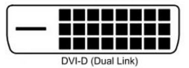

    This is the DVI adapter that ATI sent me. Will these work with the single link DVI to HDMI adapters you were talking about? I'm getting ready to place the order so I hope so.Name:  duallink..JPG
    The single link DVI to HDMI adapters should work fine, unless they are defective.
    The FirePro 2460's data sheet says: "Important: When using Mini DisplayPort-to-singlelink DVI adapters, quad output is divided into two pairs (displays 1 and 2, and displays 3 and 4)..." So it seems certain ATI sent miniDP to DVI-D single link adapters. In spite of having all the pinholes needed for connecting a DVI-D dual-link cable, the only active pinholes will be the ones required for DVI-D single-link. The rest of the pinholes are only there so the miniDP to DVI-D single link adapters will work with the male end of the standard dual-link DVI cable that comes with many monitors.

    Yea, but what I'm saying is that the adapters ATI sent me are dual link DVI-D not single, so can you connect these miniDP to dual link DVI-D adapters (the ones ATI sent)to another adapter that is DVI-D single link > HDMI? I've been trying to find the answer on the net but cannot find a definitive answer.
