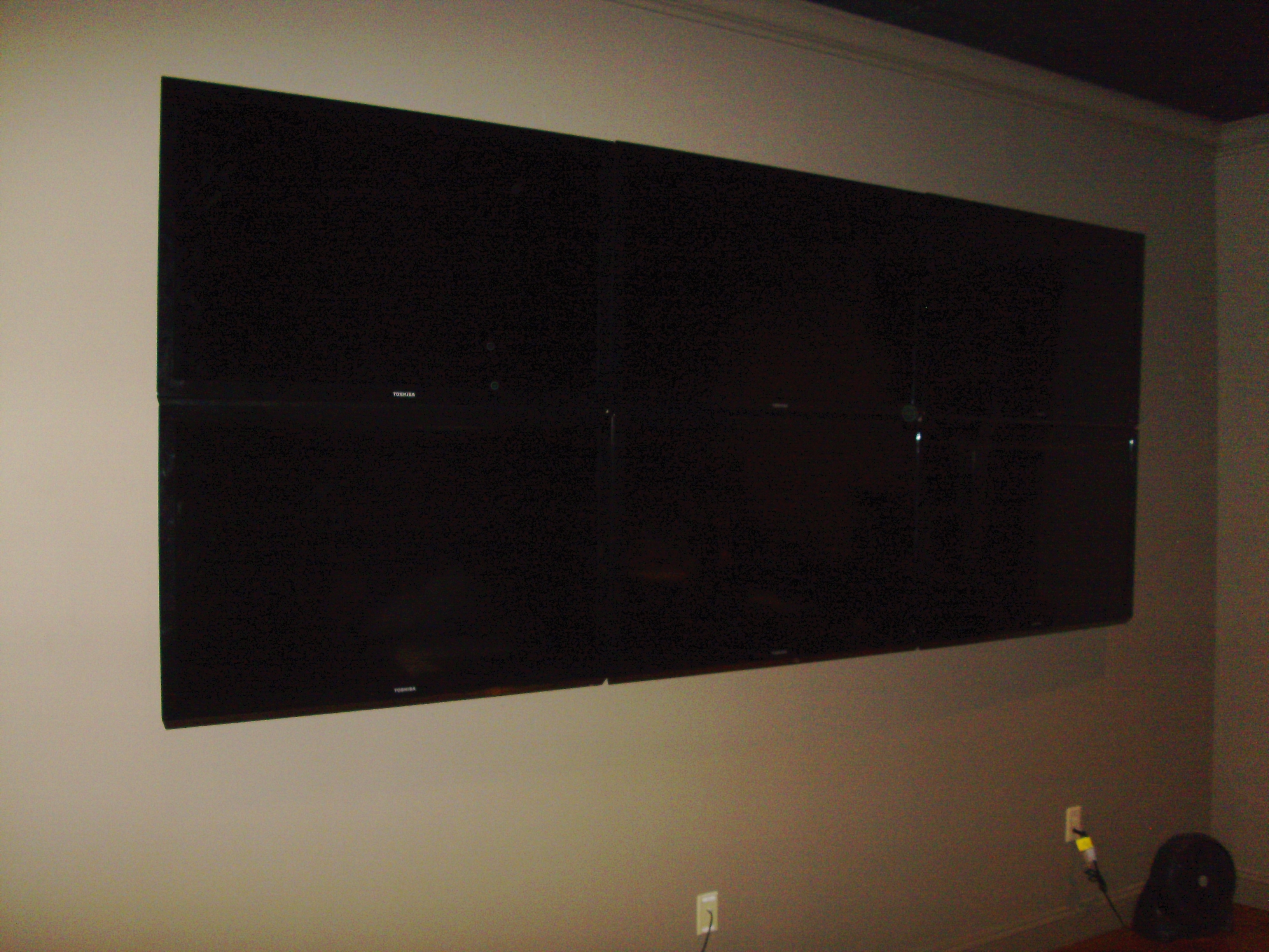

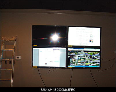

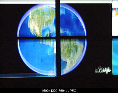

    The 1st pic is all six up and mounted. #2 was x4 up and a practice run. #3 is all six mounted but only x4 working with #4 way lighter. You can't tell from the picture but it is.
ID:	8588Click image for larger version
