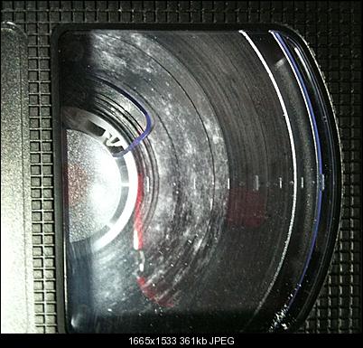

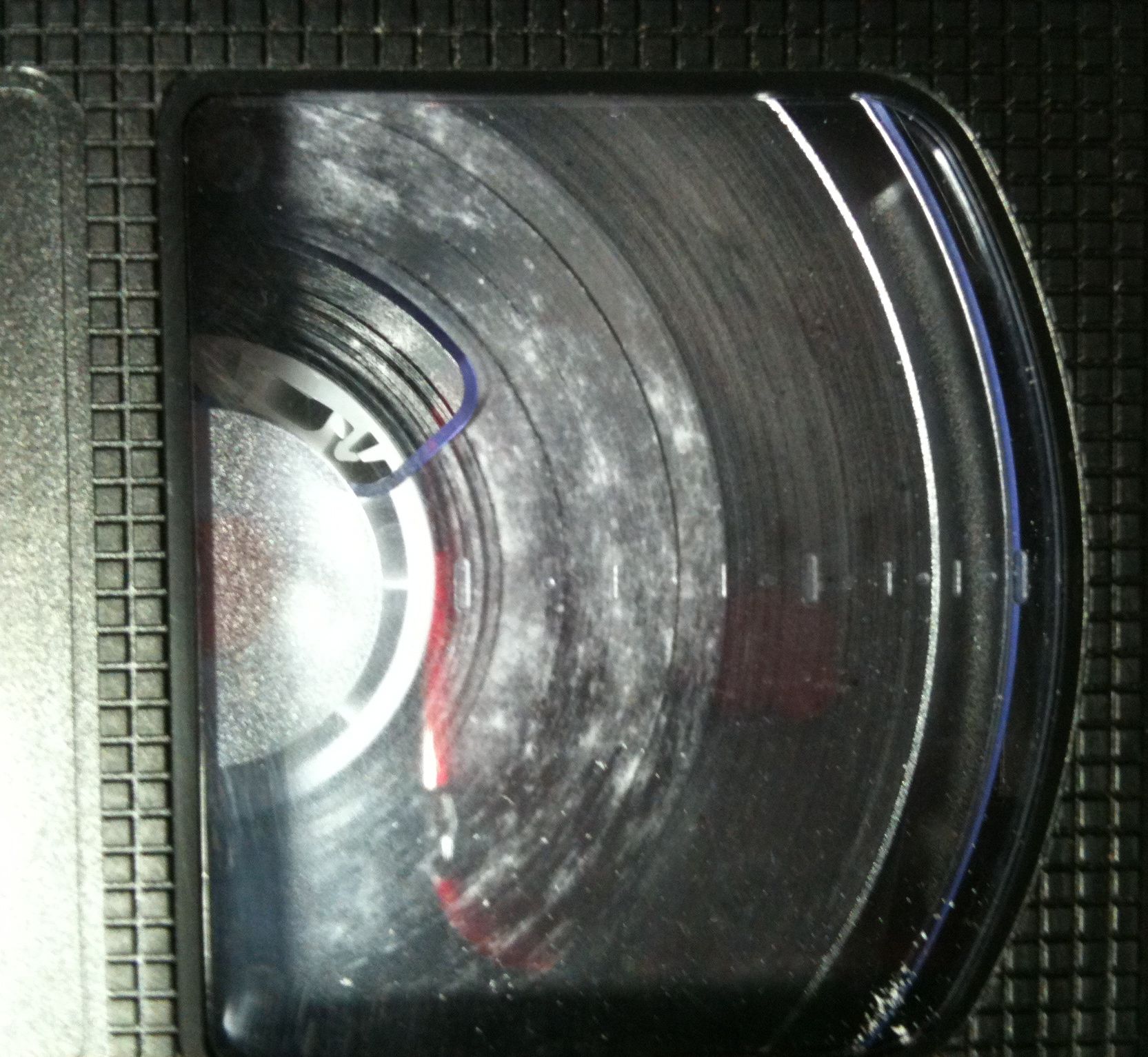

    There are one or two threads on this topic in the archives, but there was conflicting advice as to what to do. Long story short, I have some old NFL games that I want to convert into digital files, but many of my tapes have a coating of mold on the top of the film itself. Here's an example from Google to illustrate my problem:
    Some of my tapes are that bad, but others only have a smattering of mold. Advice on the Net has ranged from cleaning it with distilled water to cleaning it with rubbing alcohol. I have tried neither as of yet. So has anyone been able to salvage a moldy tape without having to take it to an expensive cleaning service?

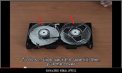

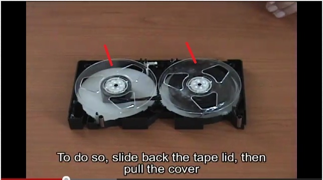

    One last question before I try to repair my moldy tapes: how to I remove the clear plastic coverings without breaking them? I need to remove them in order to swab the moldy parts of the tape with rubbing alcohol.
