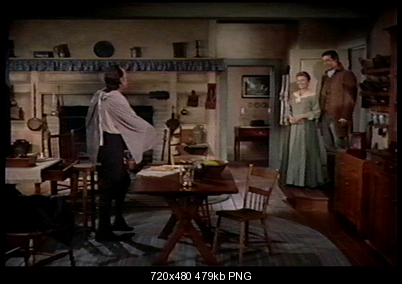

    Here's a sample:
    (Be sure to expand the image.) This is what the video looks like after I have done an inverse telecine to generate the 23.976fps result. (This had to be done somewhat manually because the original video changed phase a half dozen times from beginning to end.) There are two issues:
    1) The comb-like problem, readily visible in areas of high contrast, such as the edge of the door in the upper right. Alternating scanlines are about two pixels out of horizontal alignment. But the problem recedes and seems to be gone towards the bottom of the image.
    2) I have found that reds and browns exhibit a lack of agreement in how bright they're supposed to be, on a scanline basis. Observe the cabinet in the lower right, or the brown floor. One scanline is bright, the next is darker, the next brighter, and so on.
    These are particularly noticeable problems because in both cases - the horizontal misalignment and the bright/dark weave - the effect is temporally static, meaning that as the video is being watched, the horizontal problem doesn't ever reverse itself, nor does the bright/dark lines issue (which could have assisted in obscuring the phenomenon). So they are in-your-face and a constant annoyance. Imagine if dot-crawl was static. It's that bad.
    I don't suppose there's any real point in trying to determine why this happened. Possibly it is a flaw particular to my VCR, or how the video was recorded to tape. Bottom line is this is what I'm stuck with. So I'm hopeful that there are some esoteric Avisynth plugins that could help. I've been more than a little astonished at my luck in the past, I can tell you. ;p
    Edit: There's also an overall graininess typical of heavily-viewed VHS footage. I've had to conclude that there isn't anything that can be done about this without destroying detail better left in.
