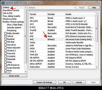

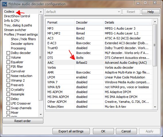

    Yes, but as I mentioned, GSpot doesn't tell you (in the codec information lines) whether or not the codecs installed are DirectShow filters, which VirtualDub can't normally use (unless, perhaps, you install the DirectShow plugin, or frameserve via AviSynth). You can try enabling the AAC codec in ffdshow: open "Audio decoder configuration" from ffdshow's Start Menu folder, click on "Codecs" in the left pane of the window, then find the entry for AAC in the right-hand pane. Under the Decoder column, make sure AAC is not set to 'disabled.'
    You can also try the AAC ACM Codec, but as I haven't tried it, I don't know how well it works.

    Ai Habara,
    The codec AAC is present in the ffdshow audio configuration, and it is enabled and shows libfaad2 just like you have in your attachment. The video is still completely out of sync with the audio.
